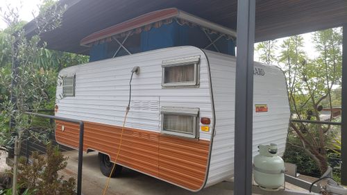

I'm hoping to purchase a Millard Circa 1971 Caravan.
Does anyone have any information or advice if it may contain asbestos.

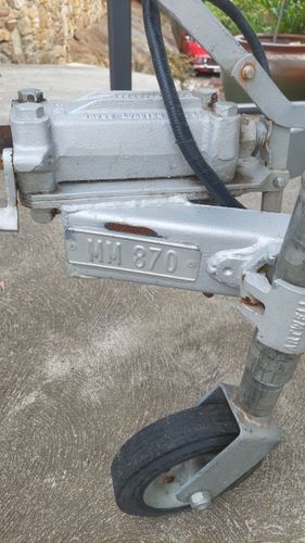

Hi Rochel19.
Based on the chassis number, the manufacture year for this Millard is 1976. I am aware of a few owners having materials tested for asbestos in other Millards of the same era and can confirm the presence of chrysotile asbestos in the vinyl floor tiles and in the old butyl mastic sealant around j-rails and windows based on a report posted last year on a 1977 Millard in the Millard & York Owners group on FB.
Asbestos is not an issue if left undisturbed, however, if the original sealant has not been replaced, chances are high it has failed and will need to be cleaned off and resealed. While many choose to DIY this (carefully and using appropriate PPE), a caravan repairer can be employed to remove j-rails (trims) and windows to reseal.
