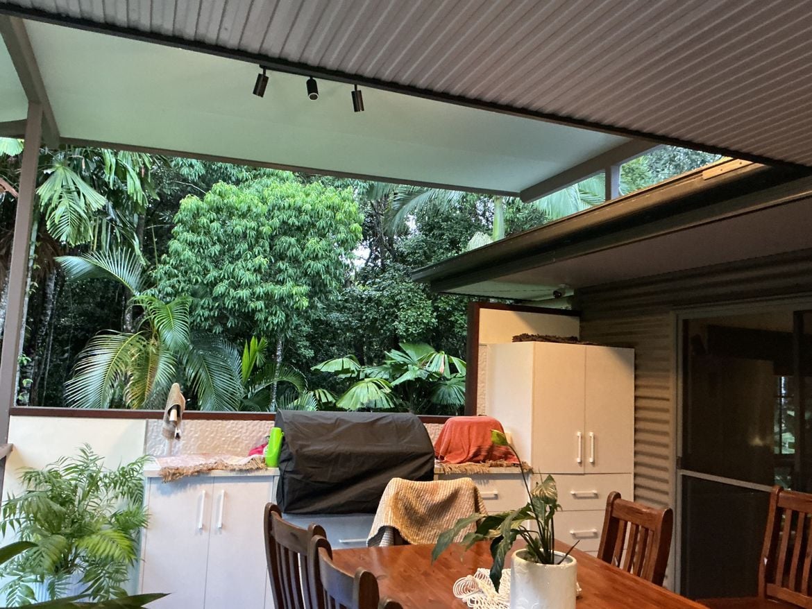

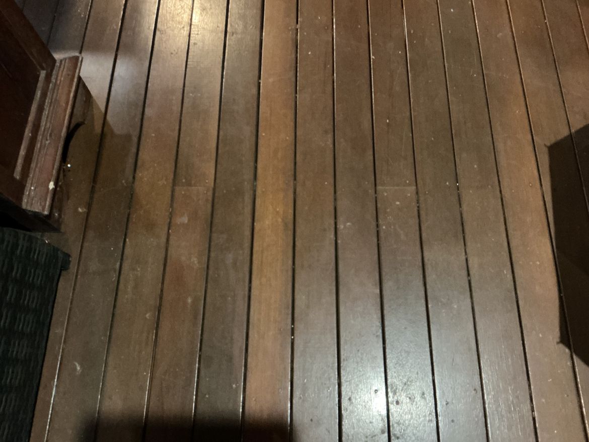

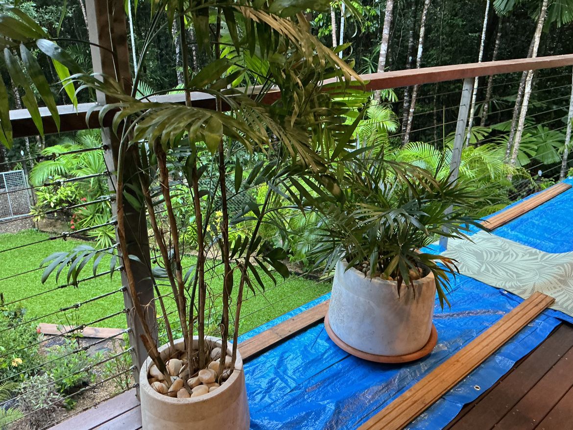

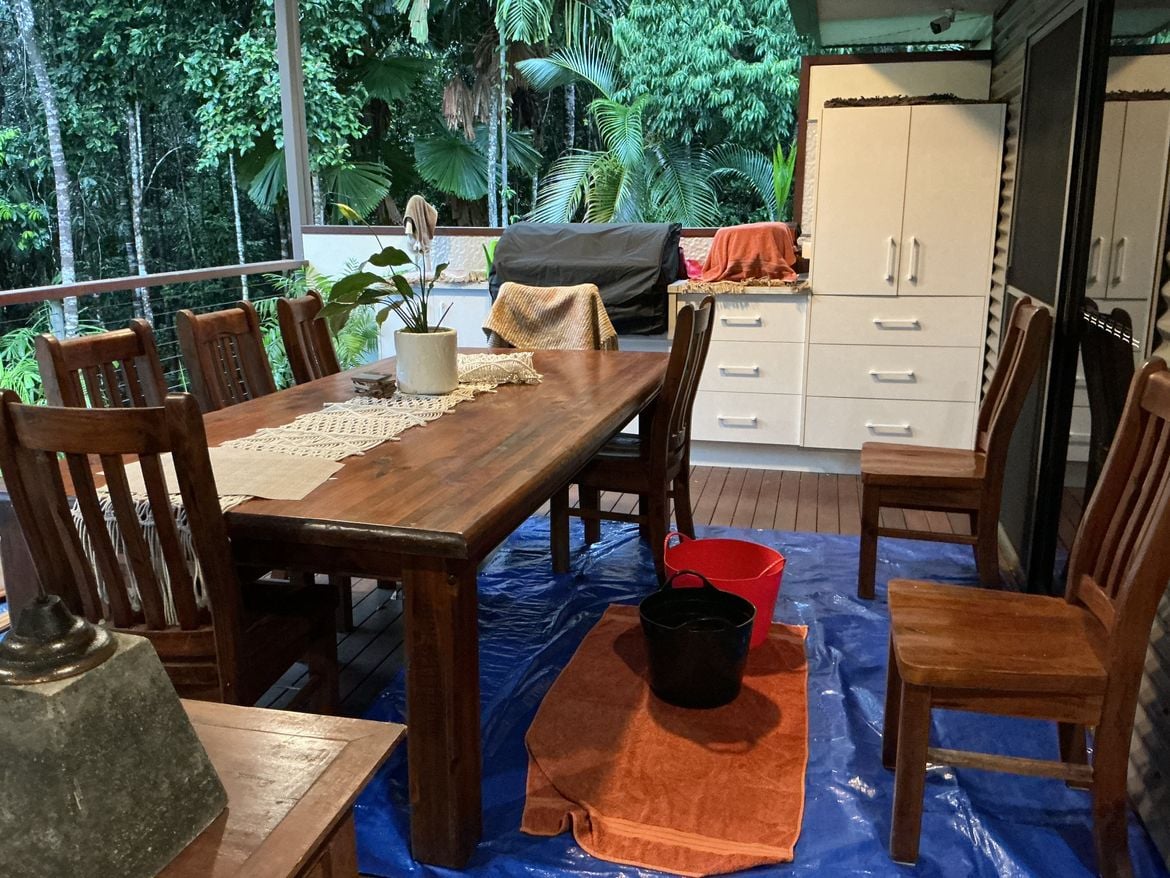

We are looking for a solution to a problem that has occurred through extensive additions. We extended an existing deck (timber decking, each hardwood 100mmW by 12mm thick with. Spacing of 1.5mm. All decking is undercover however still in the elements and susceptible to rain falling on the decking at times. We live in FNQ with high rainfall so this can also be a big problem on occasion. We have established the guttering is insufficient in one area, and this will be dealt with separately. Underneath the decking we have created a separate entertaining area which is also effected by water ingress due to decking. While we are not talking flooding, it is an issue we need to rectify long term. Succinctly the water ingress is in the majority from the gutter issue which is being dealt with, and secondly rain which is sprayed onto the decking during very heavy falls.
we don’t want to install a ceiling downstairs as it detracts from the original rustic design, plus we will still have a water management issue to contend with. Ideally we would like to tackle this at the decking level, and seal the timber joins with a product that can meet expansion if required, and be durable.

Unfortunately, it wouldn't be advisable to seal the gaps between the decking boards for a few reasons. These gaps allow the decking boards to expand and contract. If you were to seal them, even if you used a flexible sealer, sealing the gaps between every board would restrict this movement, leading to buckling, cracking, or boards pushing against each other. Water would also pool on the deck, where it would seep into the timber and fixings, causing rot and rust, which would decrease the lifespan of your deck considerably.
Unfortunately, waterproofing a deck is not something that would be simple in post, and simply sealing the gaps between the boards would just move the problem elsewhere. Instead of this, I would suggest looking at ways to keep the water from getting on the deck in the first place.
