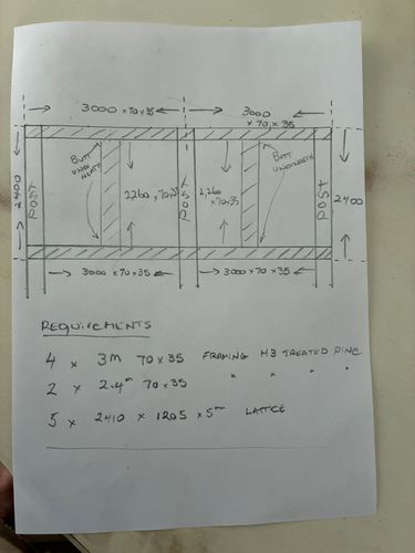

Re: lattice Screen assistance
Hi @JacobZ
Just to clarify I have attached a rough drawing to explain the width.
cheers
Garry

Garrygaz
Getting Established
 Hi @JacobZ
hopefully you can see the image I have downloaded. This is what I believe could work, however I have a couple of questions.
1. Due to width the 5x lattice sheets will be overall 15mm longer or 7.5mm each end this shouldn’t cause any issues would it?
2. Would I still need the channel framing kits?
3. What screws should I use to fix the lattice to the framework and the 70 x 35 to the existing posts.
thanks for any advice in advance.
regards
Garry
Hi @Garrygaz,
Thank you for the sketch; it is very helpful and looks like a solid start on the plan. I would consider making a couple of changes, though.
As the rails are elevated, they would need to span 3m between fixing points. A 70x35 would likely sag over this distance, so I would consider using 90 x 45mm Outdoor Framing H3 Treated Pine instead.
The slight size difference wouldn't be an issue; you can cut them using a circular saw if needs be.
You would still need to use the channel framing kits because they allow the lattice panels to be held in place, while still allowing for expansion within the channels. If you were to simply screw them to the timber, there's a good chance they would warp because they can't expand. You can see how they work in the videos on the product page.
With this being said, as the channel framing needs to be screwed to something on all sides, you would need to add one more upright to your frame to accommodate it.
You can use 100mm batten screws to screw the frame together and attach it to the posts. You can then screw through the channel kits to the frame, ensuring the screws do not hinder the lattice's ability to expand and contract as per the instructions, using a 50mm screw. These Bremick Vortex Plus Roofing Screws 6.2 x 50mm would be a good option that would match the C-channel kit in terms of colour.
Let me know what you think, and if you have further questions, please don't hesitate to ask.
