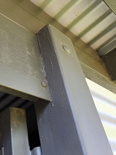

I had a rotten pergola area that I did my best to rejuvenate about 10 years ago. I over engineered the steel vertical posts. That post seen below is 100mm X 100mm steel with the rebate angle 'grinder-ed' off and the three open areas welded closed with steel plate.
I even filed a square for the 'wood' bolt to fit.
But when it came to the horizontal member, I tossed up the idea of steel but eventually went with wood. A H3 200mm X 45mm plank from Bunnings. I just felt it would be easier to connect 'things' to a wooden surface at a later date - if that makes any sense.
Anyway, just a thought.
