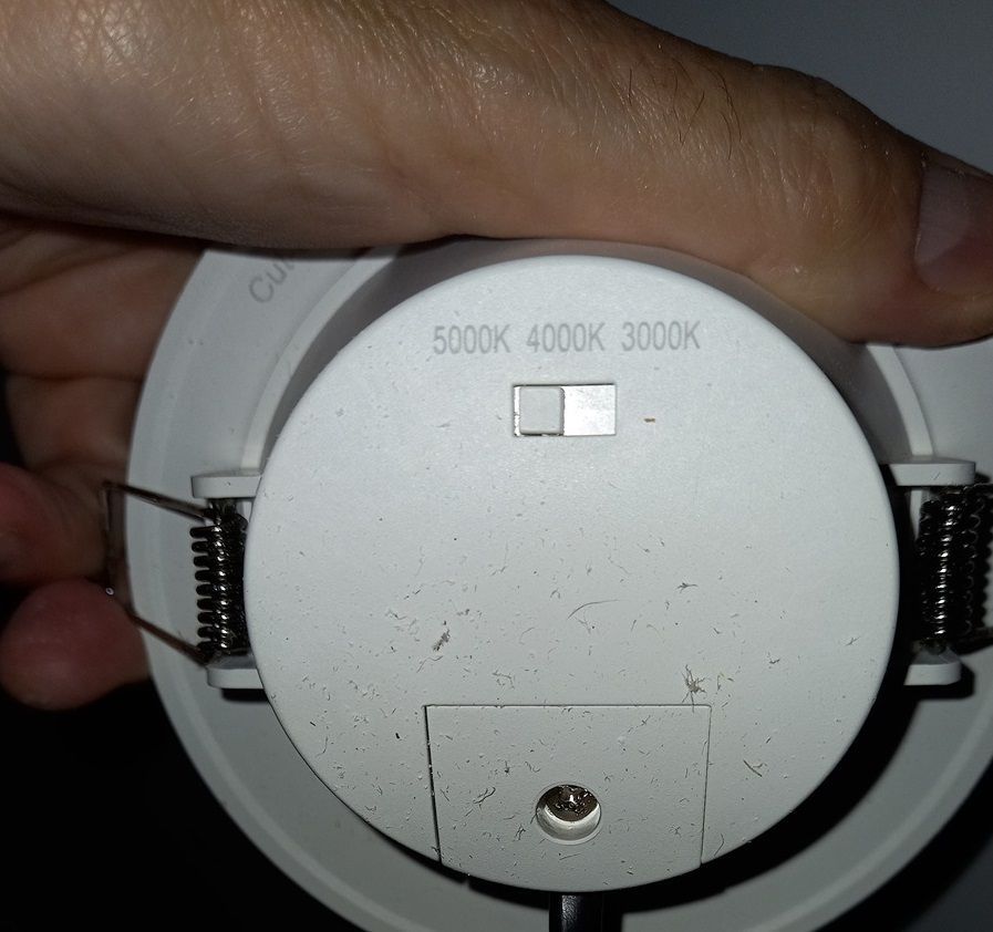

Hi Eric,

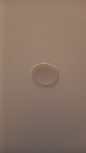

I managed to remove the downlights. Boy, the springs are strong - you could catch mice with them!! Now, I discovered that most of them are LEDs, which is fine (Photo 1). However, in the kitchen there are two lights, which I assume are halogens. The units plug directly into 240v (photos 2 & 3). They are too bright and I'd like to swap them for LEDs. I assume I can buy two LED lights the same as those installed everywhere else in the house? The dimensions appear the same. One query, on the base of the 'halogen' units, there's a switch marked 5000k, 4000k and 3000k. What do those figures refer to? Oh, and how to buy those LED units? I assume the existing LED units plug into 240v cables (I never checked). Thanks againLight 1.jpgLight 2.jpgLight 3.jpg

It appears that both of those units are LED downlights. The switched function between different colour profiles indicates it is also an LED unit, as halogen globes do not have this function. The selection switch allows you to go from 5000K bright white bordering on a blueish tinge to a yellow light at the 3000K mark. The yellow end of the spectrum is typically less stark and might be more what you're after. If switching to 4000K or 3000K doesn't help with the brightness, you'd need to look for LED downlights that are not as high a wattage.
Most LED downlights come with a plug-in connection for ease of installation, though some might require an electrician to wire them for you. The closest to those in the lounge would likely be the DETA 9W IP44 Tri-Colour Dimmable LED Downlight, which is 1-watt less bright, or you could go with the Deta 10W 940m White Grid Connect Smart LED Downlight - 4 Pack.

Spot on Mitchell, thanks. I adjusted the little switches down to 3000k, and now there's a warm glow in the kitchen!
All the best, Orlando
