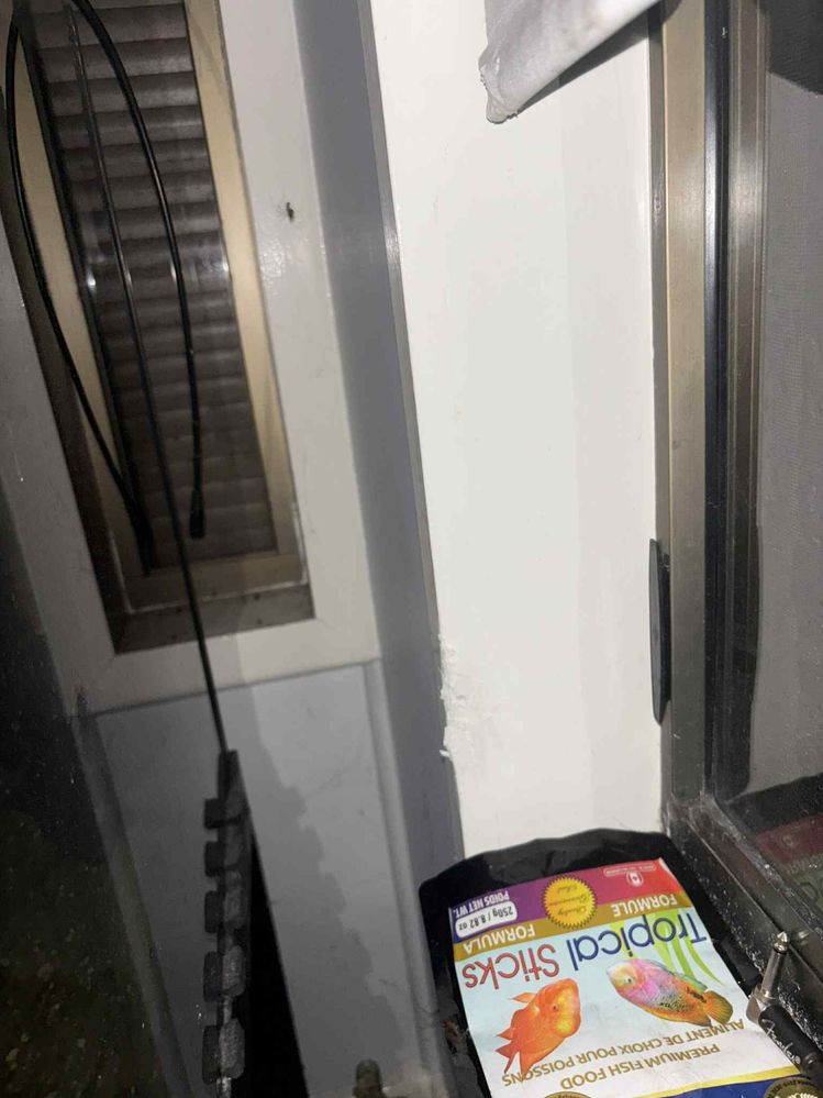

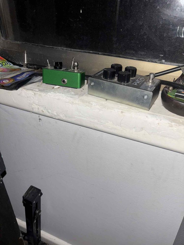

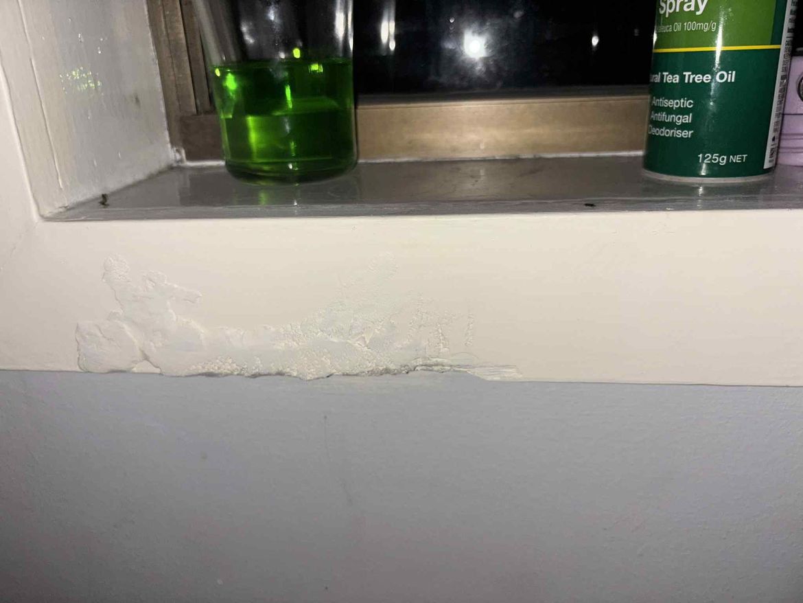

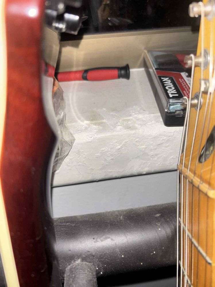

Hi there we have very damaged window seals from our dog scratching we have tried to seal what do you suggest ?

It looks like you’ve already made a good start by filling the damaged areas. The next step is to sand the filler back so it’s flush with the surrounding surface. Once that’s done, repeat the process to fill any spots you might have missed. Pay special attention to any corners when re-creating them.
Continue building it up as needed, and once you’re happy with the repair, apply a very thin skim coat over the entire damaged section. Give that a light sanding to get it perfectly smooth. At that stage, you’ll be ready to prime and paint for a neat, seamless finish.
