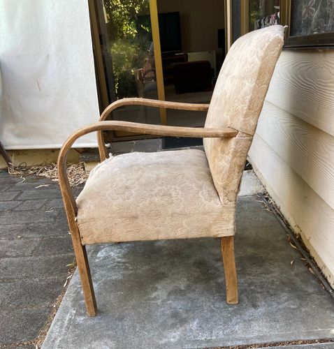

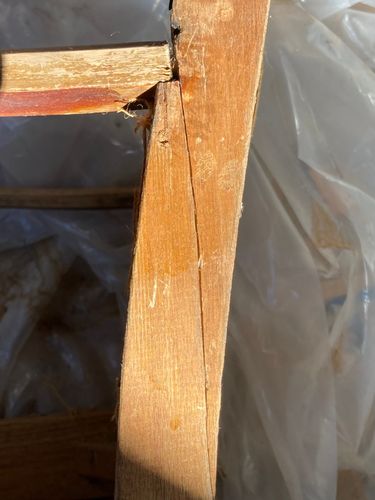

I got this old chair off Facebook Marketplace with the idea of staining the arms and legs and reupholstering it. But I have found a split in the wood where one of the arms meets the back, so I don’t know if it’s worth continuing. What do others think?
Is it fixable?

Technically speaking the parts can be joined together by using timber dowels and timber adhesive. Generally speaking, both sides of the broken pieces will need to be drilled into, and the dowels placed at a 45degree angle. It will then need to be compressed or clamped together with timber adhesive placed in between them. However, it will not have the same strength as a single whole piece.
If you can remove the two broken pieces, I suggest tracing the shape of the leg onto a new piece of timber. You can then cut it out using a coping saw or a jigsaw and then sanding it into shape. You can then reinstall the new piece onto your chair.

Mmmmm I do not know how well any fix would take. As you have removed the material I would be tempted to go with @EricL 's suggestion and use the old as a template and cut a new one out. Trying to repair a split like that and the stresses it would normaly have to handle I wouldnt be confident the glue, dowel or screws would stand the test of time.

As to your chair, I have heard/read that binding up broken joins could work, a timber glue, small pins over screws and then binding tightly with rope wrapped around the leg (That stays permanently) could work. Maybe after you have coppied the broken parts you could have a go? nothing to loose at that point.

Don't under estimate the bonding quality of a decent wood glue. I am confident that this wood glue alone and clamped overnight will restore the leg without any further technical reinforcement.
