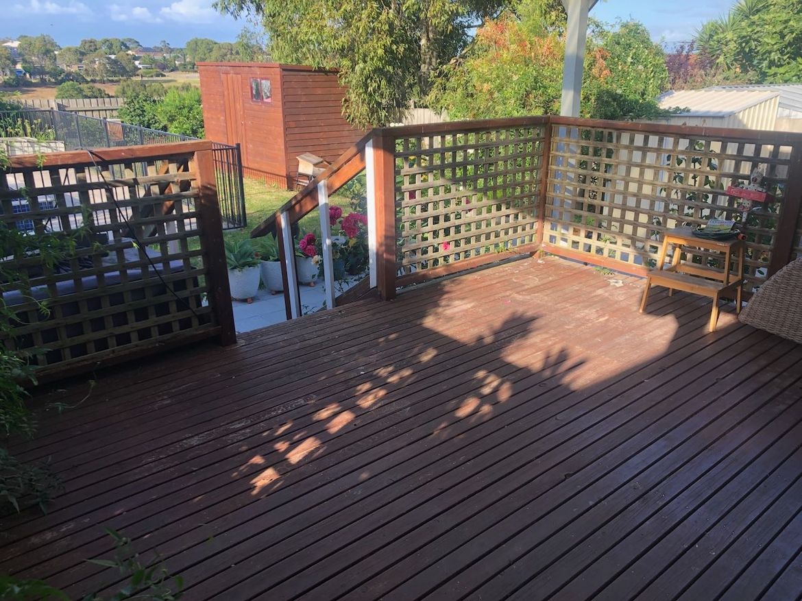

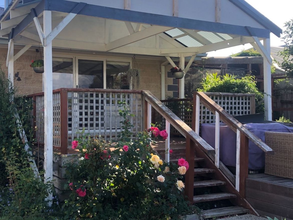

Hi we have a balcony that we would like to modernize/update and have thought about using decorative  screen panels where trellis previously way..see photo..has anybody does this? any thoughts or ideas? I know that we would need a capping rail and base for stability

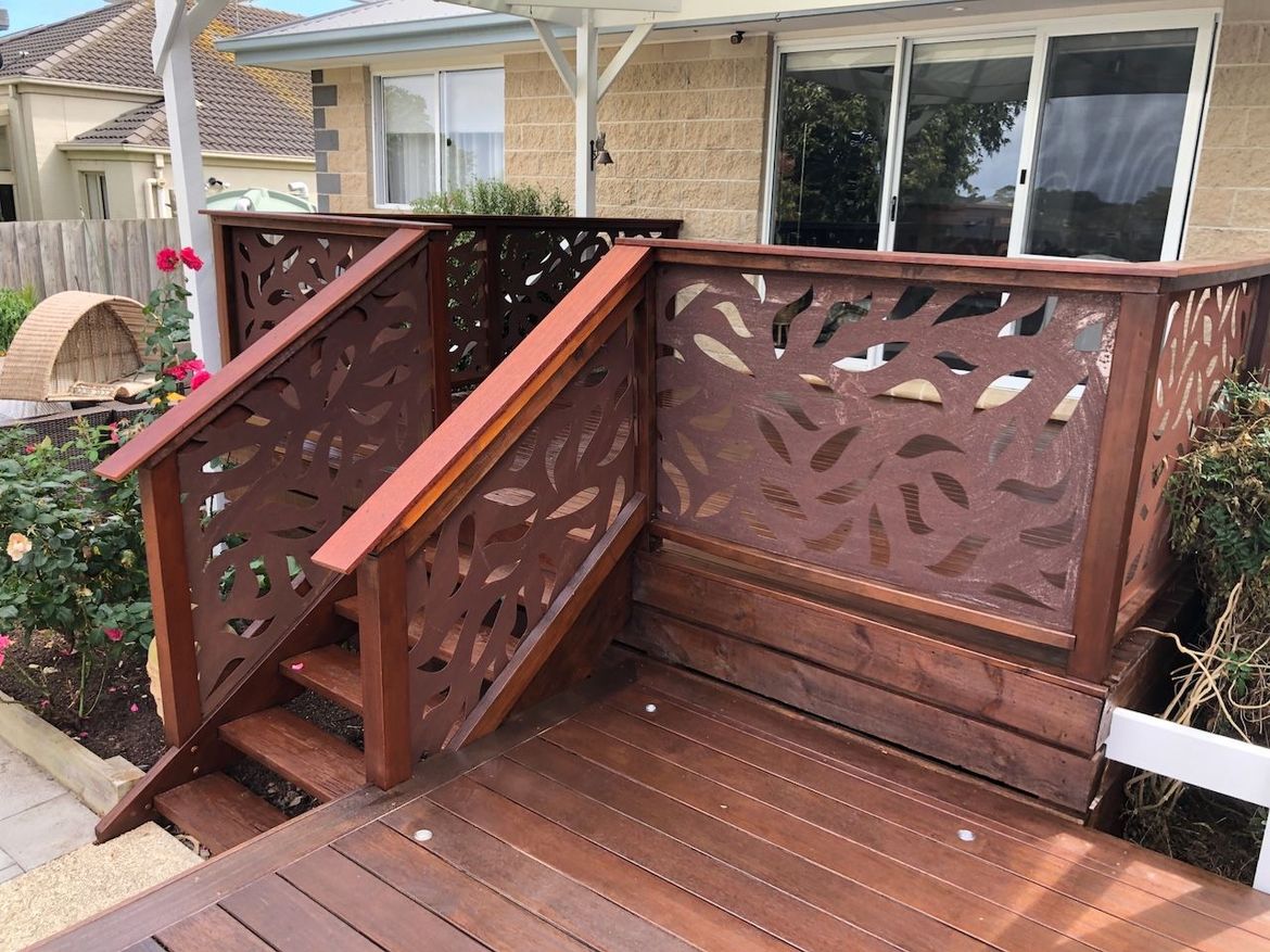

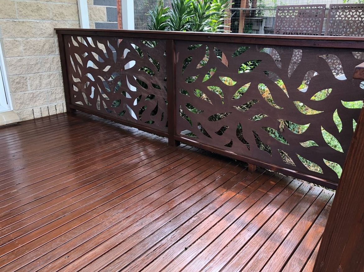

Hi @sonja1 Bunnings do a large range of decorative Corten panels that I've used on a similar project, which transformed old style trellis to a modern look. Like me you will need to trim down the length to suit using an Angle grinder and a metal cutting disc. I used a few different brands of discs most barely lasting. But came across these Kango branded ones which were a game changer, with 1 disc lasting compared to 5-6 of the others for the same price.
I then drilled holes in the edge of the panels and fixed them using 32mm flat head black screws.
Regards, Nailbag
