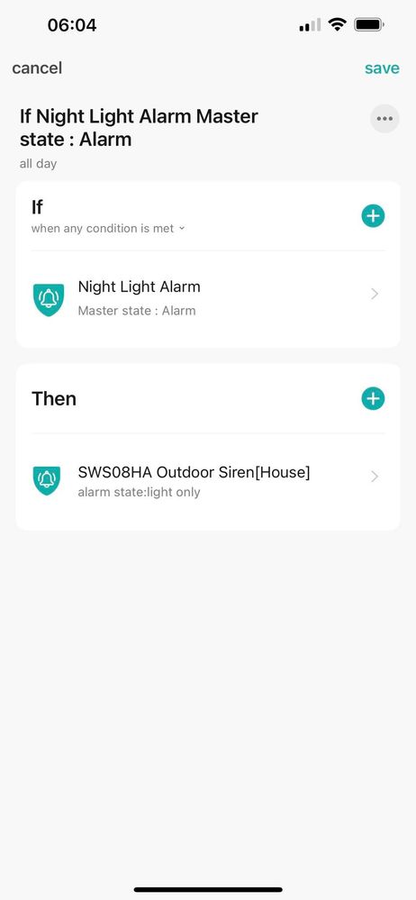

I am trying to automate when the Light & Alarm Alert System with night lights bedside assist alarm is triggered to set off the Smart Outdoor Siren...
I can get the automate to work if I turn a smart light on the outdoor siren will activate, but not if the bedside assist alarm is triggered. Also, if I try to get the bedside assist to turn a light on when it is triggered it fails. It appears that the bedside assist will only send notifications and cannot be used in any automation...

You will need to have the automation in the following sequence.
When all conditions are met
If:
Night Alarm - Triggered
Study Lamp - on
Then:
Outdoor Siren - alarm light on only
If you want it on a timer then add a countdown for anytime after the outdoor siren -on
So
Outdoor Siren ---- on
Countdown 2min
Outdoor Siren --- off
Study light ----- off
Night alarm ----- off
Otherwise if you have another setup in mind let me know and I'll help you through automation code.

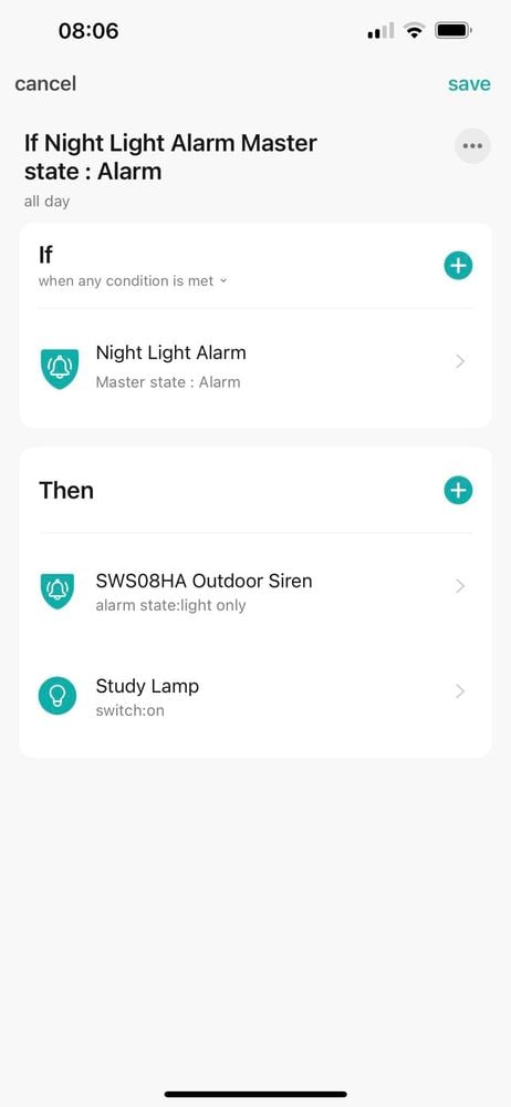

The study light was only added for a test to see if it turned on would the outdoor siren activate (lights only as it is rather loud).

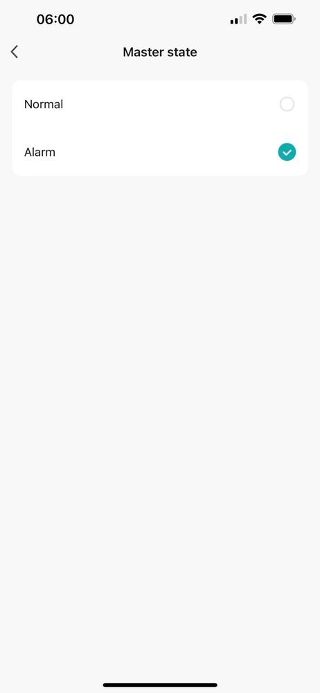

The Arlec Grid Connect Smart Bedside Assist Light Kit has two master states to choose from:
It does not have a 'triggered' state ![]()
