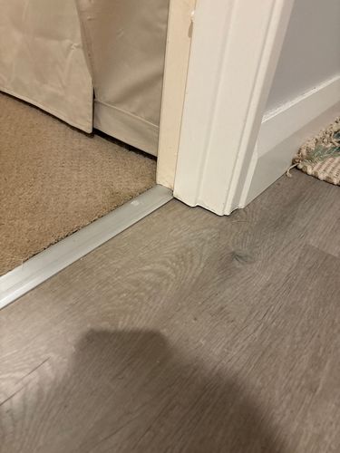

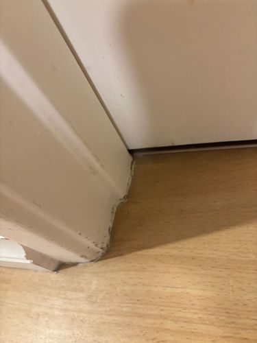

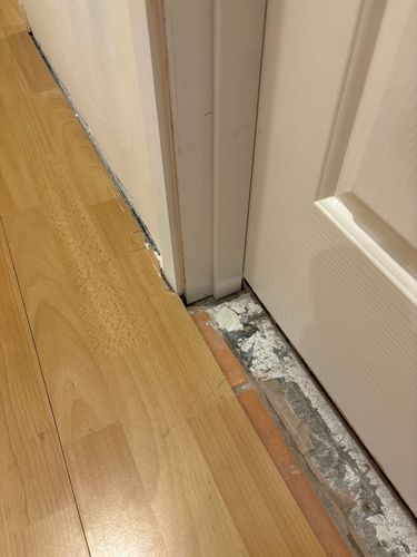

this from a floor that has yet to be demolished. Thanks for the suggestions, I’m actually thinking that the best solution maybe to leave the old tiles in place, apply a screed on top and basically raise the floor level.
the one we replaced
Hi @carter193,
Raising the height of the substrate would be a good way to get around the difficulties of replacing several metal door frames.
If you wanted to add a layer on top, you would need to remove the floating floor to allow a self-levelling compound to be poured over the top. The floating floor is not a suitable substrate for a self-levelling compound as it is designed to move and will cause cracking if movement occurs.
Luckily, there are options such as Davco Lanko 184 Flexible Floor Leveller that can be ordered through your local Bunnings Special Orders desk, which can be applied over the top of a tiled surface. This can be used at a thickness of up to 25mm, so it should be great to raise the floor level to a height where you can slip the new floor covering underneath the metal door frames with minimal gap.
Start by removing the floating floor using a prybar. Once all the floating floor is removed, examine the tiles by tapping each one and remove any found to be loose or drummy. There is no need to replace them as the floor leveller will fill this void.
Once you've inspected all the tiles, thoroughly clean the tiles to remove any dust or loose material that will affect the self-leveller's adhesion.
Once prepared, pour the self-leveller following all manufacturer's instructions for use.
You might like to check out How do you level a floor? for some guidance on the process.
