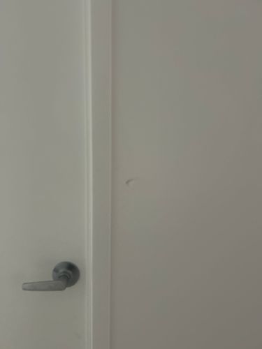

I was moving furniture and dented into wall can I have advice on how to fix it at home or would this have to be done professionally
Hi @helpwithrepairs,
There would be no need to have a professional come out to fix this one.
I would suggest using a patch kit such as this Selleys Spakfilla Wall Repair Kit.
Check out How to Fix a Hole in the Wall for some guidance on the process.
Let me know if you have any further questions or require further guidance.

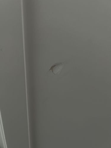

Hello thanks for your reply I had a question it’s about 2 cm or less big would I have to cut the patch and would it be noticeable
it is pretty small so would I have to cut the repair patch to the size
Looking at it again, considering it so small and there is still plasterboard behind it, you would likely get away without using a patch.
You should be fine to just apply some Spakfilla Rapid Gap Filler, give it a sand with a Sanding Sponge, then paint it.
