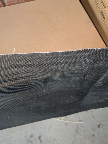

How can I insert back Aluminum fly screen on security door front entrance? It got off the door.

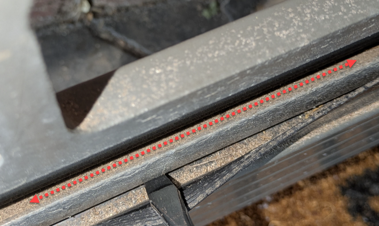

Hi @softkun123,
The logical place for it to sit, from what I am seeing, is this channel here.

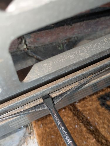

Can you see anything that resembles Flyscreen Spline? Is that a spline just above the dotted line in the above photo?

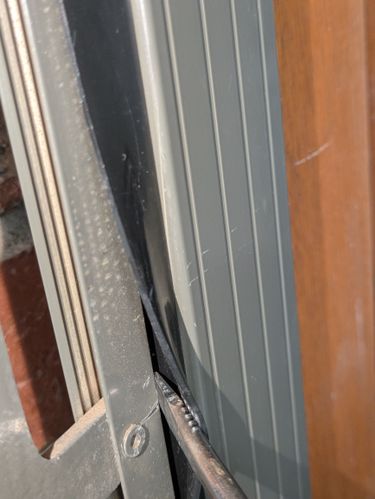

If not, does that aluminium piece that you have your screwdriver sitting under seem to be able to lift out?
There is something around here that should be the solution. I'm thinking that there is either a spline at the top of that channel that you would need to remove, reinsert the screen, and then reinstall the spline using a spline roller, or part of the aluminium lifts up, the screen is reinserted and the aluminium clips back into place holding the screen in place.
