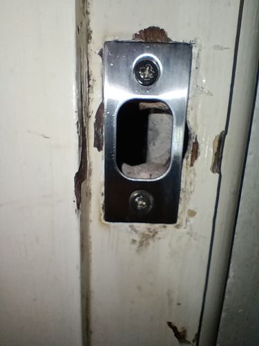

Hi folks,
I am having some trouble removing a door latch. What the problem is, is that the one screw that is installed had to be drilled through but the head snapped off when extracting it so I am now left with (see image) and on-top of that the other fitting securing the latch seems to be an Allen key fitting but I might be wrong. Any advice to remove these would be greatly appreciated.
Regards,
T.

I had another thought to get the screw out since you are bogging the holes anyway. Basically to pry/dig away the timber around the screw enough to get a good bite on the end with vice grips. These have awesome holding strength. You should be able to then simply turn it clockwise. This to @Dave-1 point would be easier than drilling the screw out being in wood and not in metal.

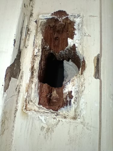

Appreciate the info, have now got both screws out, now to patch up the area with bog and chisel out a bigger place for the strike plate.
Will update when completed.
T.

Fill the hole/s just slightly higher than needed. Then as the bog goes off, use a sharp chisel to lightly shave off the excess level with the door frame. This is much easier to do at this stage and beats sanding as bog cures very hard. I just did the exact same task last week when a client wanted to swap out an old deadlock with a smart one, which had a sticker plate system 1/3rd the size.

Job complete, will eventually paint and look at filling the gap to right of strike plate and painting but there are a lot of jobs around the house before I paint! I'm happy with current result. Thank you very much for your expertise,
