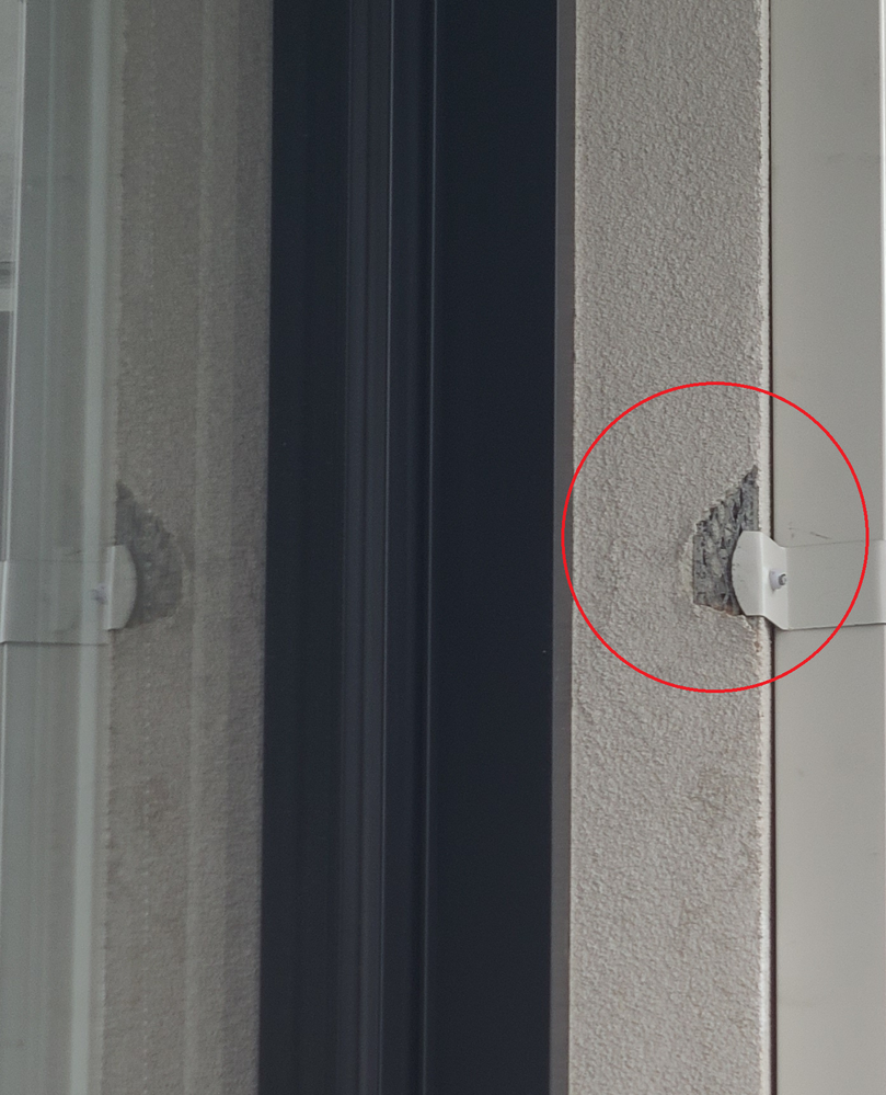

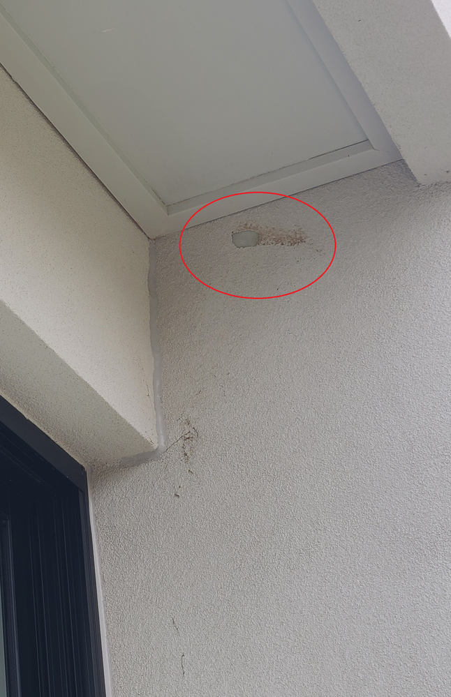

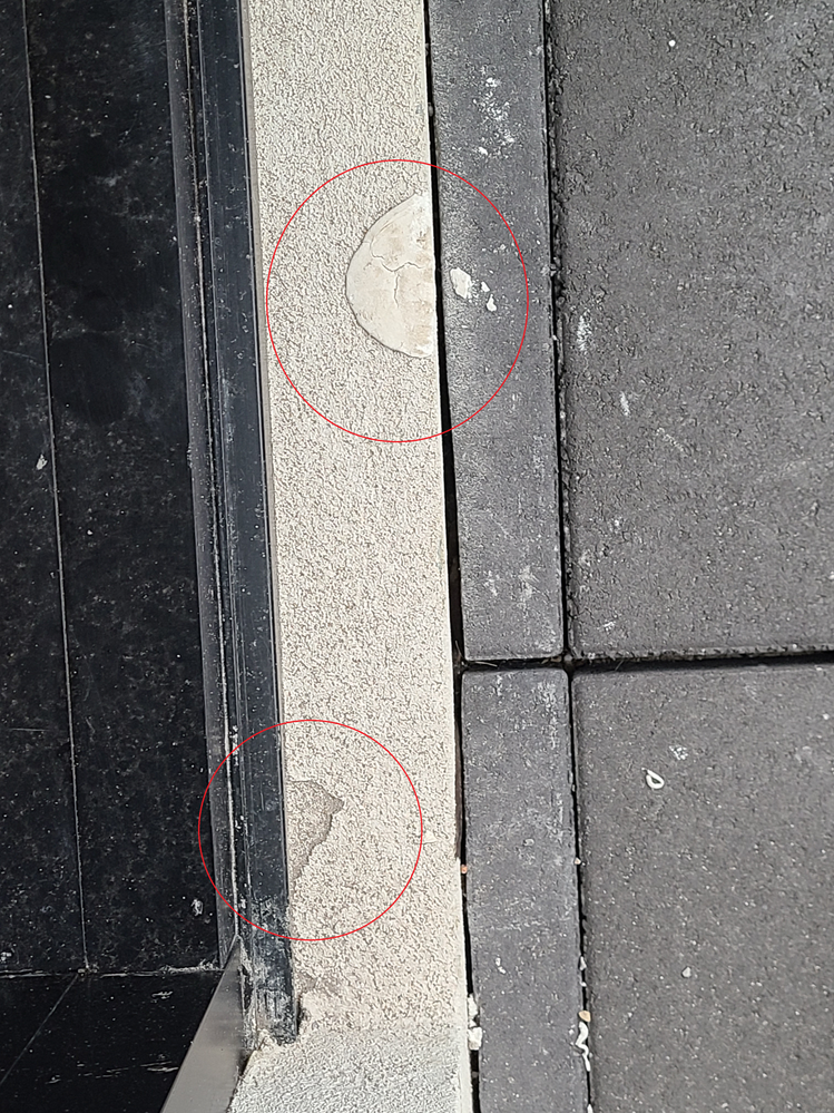

There are a few damages to the outdoor rendered wall. How can I repair them? Thank you!
Hello @surveryhk
Welcome to the Bunnings Workshop community. It's sensational to have you join us, and thanks for sharing your question about your rendered wall.
The general steps are to clean the surface of the damaged area to make sure all the dirt and debris are removed. You then use an appropriate filler such as Polyfilla 500g Exterior Brick and Render Masonry in combination with a UNi-PRO 75mm Real Good Paint Scraper.
Here is a handy step-by-step guide: How to repair a rendered wall by @Nailbag
