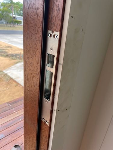

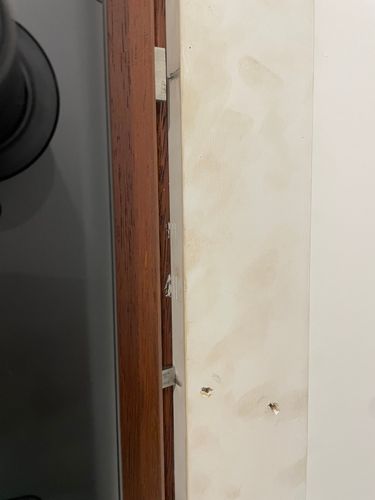

Would it be possible for you to take a few photos of the striker plate and where the damage to the door is occurring when it closes. Once our members see the installation of the striker plate, we can then make recommendations on how to move forward.

Welcome to the Bunnings Workshop community. It's sensational to have you join us and thanks for sharing your question about your Philips striker plate.
Thanks for sharing those photos of your door frame and striker plate. In order to protect the timber frame, I suggest covering the edge with a Metal Mate 12 x 12 x 1.4mm 3m Aluminium Equal Angle - Silver. This will protect the edge of the timber frame, and the aluminium will absorb the leading edge of the latch.

Evening @lachieb93
Looking at your pics and that plate. The plate looks a little proud of the timber? I am wondering if the door latch and the plate are mounted level with the surface of the door? The striker should really slide easily over the edge. I would think if the lock is supposed to have a curved edge then the kit would have one. That leeds me towards thinking that either the plate with the screws that looks a little proud or the latch is out of alignment.
