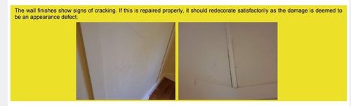

This is some pictures from the building report.
I'd say they move 3-5mm at most.
There are quite a few large cracks in the plaster, maybe after we fill them in it will be more sturdy?

Thanks for the photo tho it dosnt really show what I was after. Any chance for some photos of as is and then when you push it?
Cracks happen in older houses for sure and can be repaired easily. They will not stop the wall moving tho.
If you show us some photos from further back of the general area it will help. As @iveg has mentioned there could be a few reasons why the plaster shifts.

This looks like it is Masonite or fibre cement sheeting. Be careful working with it as there is a high chance it contains asbestos.
Firstly, be sure there isn't other signs of water or pest damage causing it - in which case further investigating is necessary.
If it's just the lining that is flexing in that era house then I suspect it just needs some more nailing or screwing the lining into the frames in more places. You will need a stud finder and safety gear if working with asbestos.
Look behind any PowerPoint switches or damaged areas to check what the sheeting is.
Unfortunately Australian houses of that era are built like a 3 year old drew them. I have renovated in the UK too. The flex in sheeting may not even matter. Just fill the expanding gaps with a flexible gap filler that you can paint over.

@redbournreno sums up my thoughts well. The sheeting likely has just pulled away from the stud framing and needs to be fixed back in position. That is great advice about having the sheeting and how to assess for asbestos. Please take all precautions when working on a house of that era. Once the sheeting is fixed back in place, you can fill the gaps and cracks.
