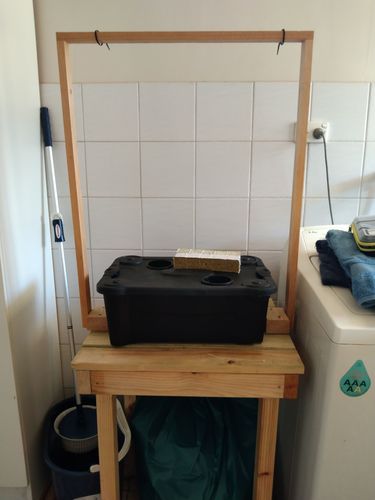

Starting to put it together..
Prof
Re: I'm Growing Hydroponic Tomatoes
The grow light support is up..

That's looking great, @Prof! I'm keen to see how you'll deal with the adjustable height lighting.
Please continue to keep us updated on your progress.
