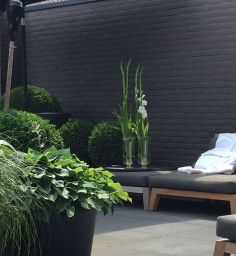

Love something like this for example:

Do you think going for a lighter grey like above, or a darker grey like Colorbond Monument is more in fashion? I'm tending towards maybe a darker colour.

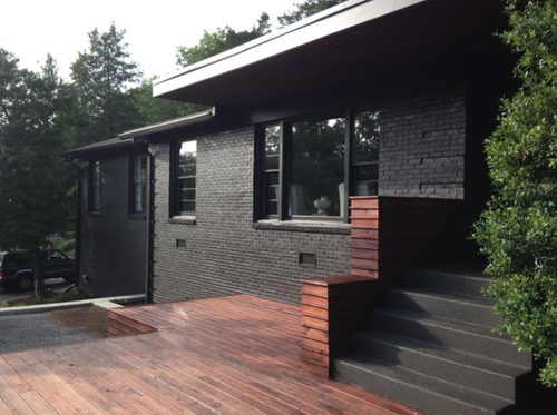

Maybe a little too dark, but these seem nice, but not sure if they suit my house:

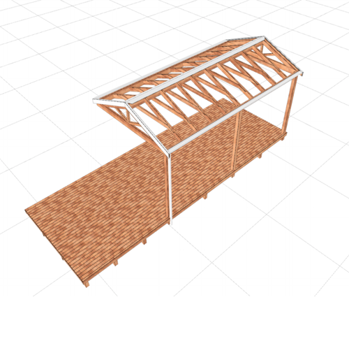

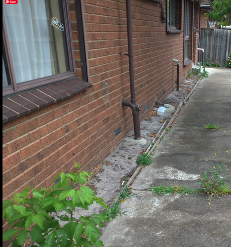

Back - planning to put a 9m deck 30cm high and a patio 6m of it That large window at the end of the photo has already been converted to a sliding door:
This is what the deck / patio will look like with a clear roof (potentially EZ-GLAZE)

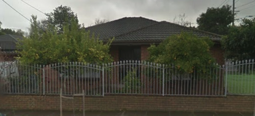

This is the front space of the house:

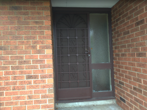

Door has been replaced with a much more modern black screen door with palm tree cutout and the glass is now clear. Will try and attach an image of the update later. (These images are all from the day we nought it)
(Tree on the left has since been cut back a ton and will be removed)
I'm not planning to do anything with the roof tiles, and I'll look to try repaint the reddish brown gutters and fascia boards. A bit hard to paint the reddish brown window frames as they're sliding. Another painter told me the paint would likely crack after 2 years.

Re. Colour choice..... I love Colorbond colour Monument. It's dark but really popular. If it's too dark for you, then consider Basalt.
