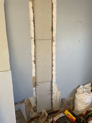

2. I need to patch where the old wall heater was and now has a sheet of cement board to render over (5-10mm), but there is deep gaps on the sides (see photo)

I was going to keep it simple and cost effective, but then I read you need to use a different kind of render for cement board and I don't want to have to buy different materials for each task!
Can I use Dunlop 20kg Multipurpose Acrylic Render  as a base for all tasks, then apply a top coat?

I was just wondering, is there any reason I can’t use a sand and cement mix for the base and chasing? I have quite a lot to fill and so think it would be more cost effective, even if I need to put an additive in.
Re: Which render should I use?
Hi @squeakysim,
You could use bondcrete. It will need to be mixed with water following the instructions on the packaging. You would need to apply a sealer coat, which is a 1:4 ratio, 1-part bondcrete to 4 parts water, then apply a bond coat, which is 4:1, 4 parts bondcrete to 1 part water.
You should be fine just using sand and cement mix, which is more or less what mortar is anyway. You could also use the bondcrete as an admix to help it cling to the surrounding surfaces.
Just make sure you apply it in layers in the deeper areas.

I haven’t started on the cement board section yet, but before I do I want to check if I need to prime it with anything special before applying the Fine Coat Render?

You can continue using the Bondcrete in the same fashion mentioned above. It will work just the same as it would on brick and block walls.

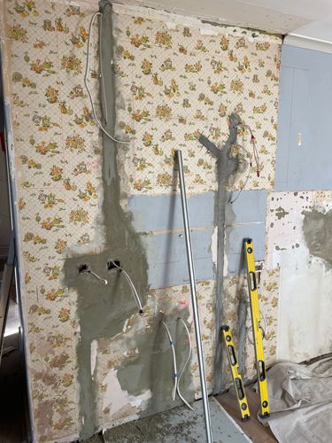

I’ve done the fine coat render on the main part of the wall, unfortunately I’ve not got the finish anywhere near as smooth/flat as I’d like. Fortunately, the majority of it is covered by cabinets or tiles. However there is still a section that will be painted. I was wondering if I can skim a really thin coat of plaster over it to try and take out the imperfections?
I’ve only put the first coat of render on the cement board so far, so I’m thinking of using plaster to finish it as well to try and match the walls on either side if you think that would work?
Slight deviation from the original post, but all the wall in my place have what appears to be lining paper under the paint (see pic - the blue is painted, the beige is the ripped paper, and then there’s the old plaster). Can you suggest anything that I should do to transition the patched section with the old lined walls? I had wondered whether feathering the plaster might work, but don’t want to end up with plaster peeling off where I’ve gone over the paper. Failing that do I need to try and cut the paper back, and try and fit another sheet so as to try and match them up…??

Hi @squeakysim,
You can skim coat the render using hardwall plaster mixed with hydrated lime. Check out How To White Set Internal Render for some guidance.
Working out exactly what it is would be a start. Do you have any other photos you could upload? If you take a utility knife or the corner of your trowel and make a cut in the paper, what do you see?
It looks like it could just be the face of some plasterboard or MDF.
If it is not moving, I don't think it is anything to really worry about. Your plaster should still stick to it.
Allow me to tag @Nailbag and @Dave-1 to see what they think.

Good Afternoon @squeakysim
I would try cutting off a section of that shiny pape rsurface next to the blue paint to see whats under it. As @JacobZ has suggested it could be plasterboard and if thats the case I would cut a straight section so theer is no loose paper and continue with your rendering. (Every job we do we get better :smile: ) I have not rendered anything and hope one day when I do it goes as well as yours.

Hi @squeakysim
As both @JacobZ and @Dave-1 mentioned you should be fine to feather the top coats out without fear of long term wear and tear.
The important thing is to ensure the surface is clean of any loose material and especially the old plasterboard paper edges. I use a sharp blade to make clean cuts and remove it well back from where it’s lifting.

Thanks @JacobZ @Nailbag @Dave-1 !
There's no plasterboard, the wall is hard plaster with lining wallpaper on top that's painted blue.
Moving left to right from the crack, there's white plaster, a light coloured painted, then where the paper surface is torn, and then blue paint on top.
I will be tiling other areas that also have this lining paper on the wall, do you think the painted paper should be removed before I tile...? My feeling is probably yes, but wondered if I'm over thinking it!?
