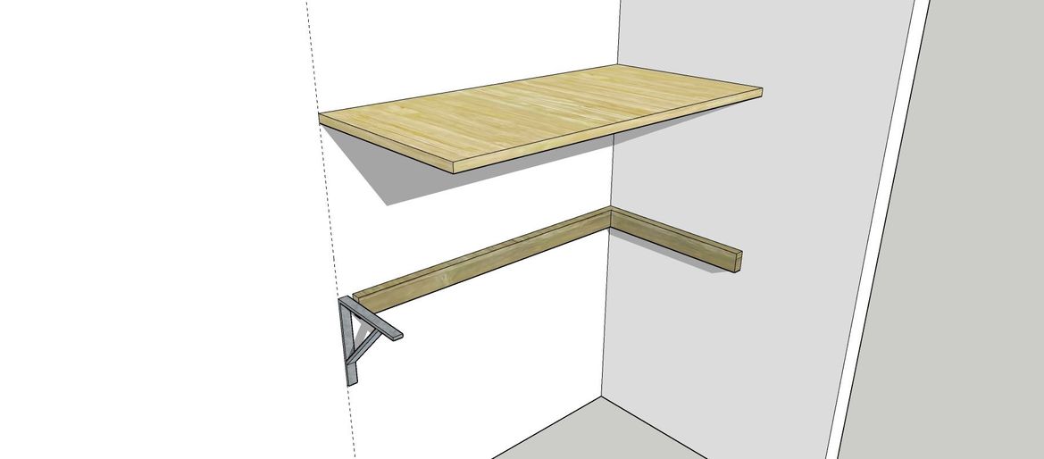

Hello @cdunton
As promised here is a sample image of how the support pieces can be put into place to hold the benchtop to the wall.

Re: How to affix a laundry benchtop?
Thank you again Eric. Would I need to pre-drill the holes into the tile and stud before finally affixing the timber and bracket?
Dave-1
Community Megastar
Afternoon @cdunton
Yes, It would make it easier to do so. One thing that has worked for me when drilling holes in tiles (only done a couple as I generally avoid it as I always worry about the tile cracking :smile: ) Is to place a cross of tape over the spot that I want to drill. It stops the drillbit skittering over the surface so easily. Id buy a fresh drillbit for tiles and start of with low pressure when drilling.
Hello @cdunton
That is a yes for me as well. I suggest using a QEP 8mm Diamond Tile Drill Bit to drill into the tiles.
