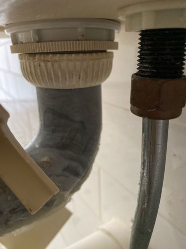

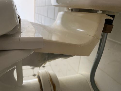

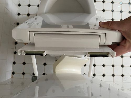

Hi, I replaced Mum’s toilet seat a little while ago with a Caroma one shown in photo. The old connector plate from the Fowler porcelain cistern to the new seat is discoloured and broken on one side (see pic). I bought an Estrelo replacement from Bunnings today and cut it to size, but it seems too narrow (19.5cm W). The old connecter plate is 21.5cm wide and seems to slot into the back of the new toilet seat. I don’t know what connection plate to buy to fit the cistern and the seat? Can you please tell me what will fit?
Also, how exactly is it meant to attach to the seat? Abutting it or slide into it? And where on the pipe fitting should it go?

It sounds like you'd be after this Caroma Cistern Connector Plate , which is 210mm wide. A connector plate is typically designed to slot into the back of the seat and connects the the pipe fitting directly under the cistern.
