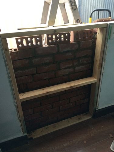

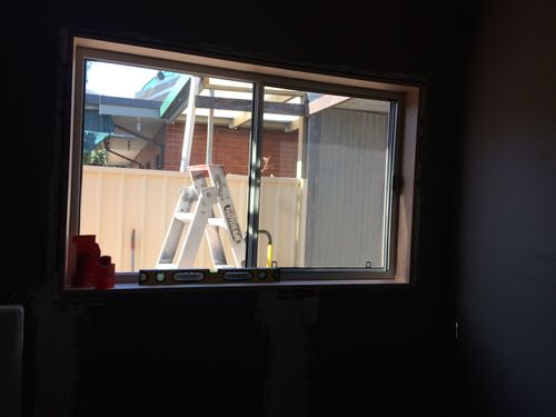

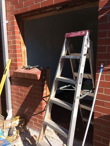

I recently removed an old door and window from a bedroom (which used to be a laundry) and replaced it with a massive window and a brick veneer wall. BUT now that I've almost finished I've realised that I may encounter a problem down the line with moisture. So I'm not sure if I was supposed to put anything between the wood and concrete or between the bricks and concrete.
Have I made a big mistake? If so can this be fixed? Any advice is much appreciated ![]()

There should be a Damp Proof Membrane (DPM), weep holes in the brickwork and waterproof flashing fixed around the window & on the timber frame inside the cavity?
It appears the new window opening hasn't been properly flashed this can become a major problem on the weather side, you might want to consider an awning over the window to keep the water from ingressing the window/brick edge..if that helps

There's definitely flashing around the window, and yes I fixed it in properly but it's hiding behind the aluminium frames I added around the window frame as the gap was ugly and you could see the lental at the top. I'll see if I can find a photo to show you what I mean. regarding that smalltimber frame, this is where I'm worried as I forgot to use some damp proofing material. Re weep holes, are they necessary if the brick work is less than 1m wide? Hmmmmm So is there a way I can fix this?

@Abby I've put up a generic detail for a brick veneer wall flashings that I use
You may not have all of them listed but let me know so hopefully we can work a solution for you. I highly recommend weep holes beneath windows..tho they can be drilled in later
