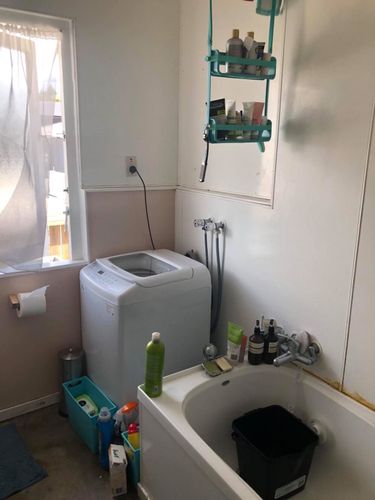

Bath.jpgLaundry End.jpgLengthways from Door.jpgRight Side.jpgShower 1.jpgHi, my name is Kat and I have just bought my 4th house, but the first to need urgent renovations (1950s concrete bungalow w cement tile roof).  While I can do most DIY basic repairs, this will be the first time I have needed to pull down walls and remove major fittings.

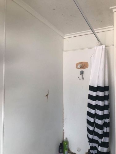

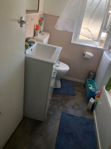

My small bathroom (3.6m2) needs a complete rehaul. It is rectangular in shape - 2m long and 1.8 wide - doubles as the laundry (washing machine only, no dryer) and has one small, wooden, side-hung casement window.  Lack of ventilation and little/or no proper undercoating or waterproofing, has caused mildew on the celling and scotia and cracking and peeling of the paint.

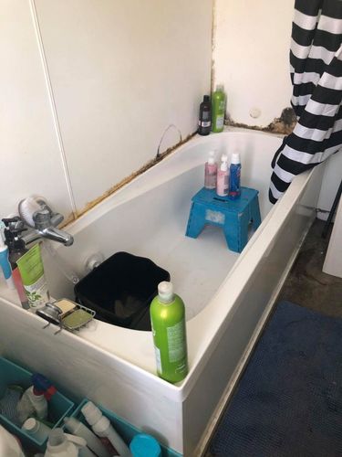

The seratone around the bath/shower is badly damaged and water is slowly leaking into the wall cavity behind it.  The whole house is concrete - walls, floors - definitely not concrete blocks, but solid slabs (I think).  I want to remove all the waterproof wall panels in the bathroom, back to the concrete and need to know what I need to do to the existing concrete, to ensure it is waterproof.
To maximise the small space I plan on removing the bath and installing a shower instead, replacing the existing toilet with a smaller one and putting in a new vanity.

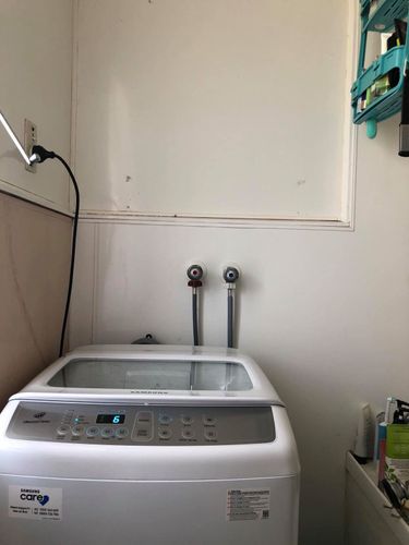

1. Turning the water off for my unit also turns it off for the other 3 units in my block as there are no separate water meters.  How can I stop the water from pouring out once I have removed a tap?  I will need to turn the water back on before installing new taps.

I would think there is a stop tap of some sort of a seperate meter connected to your Unit. But if that’s not the case then I would notify the other Units to say you are turning the water off, then get a plumber to cut your line at the house and add a stop tap/ gate valve. So next firm you will be the only that will be affected when the water is turned off

Best suggestion from @LePallet get a plumber to install your own shut off tap for your unit only. This will make life easier for future repairs and renovations where plumbing is involved.

Have you made any progress with your project? I would presume that your walls are clad with Villaboard, as this is typically used in wet-areas. If there is no timber frame, then the sheeting is potentially attached directly to the concrete. When you tap with a hammer on the walls, it is likely sheeting on a frame if it sounds hollow. I'd suggest starting with the bath, as once you remove it, it will hopefully expose a portion of the wall.
The only difference with your walls and what you have seen is that they have tiled over the sheeting and have a stud frame wall. Let us know if the walls are just painted concrete, but I find it more likely sheeting.
