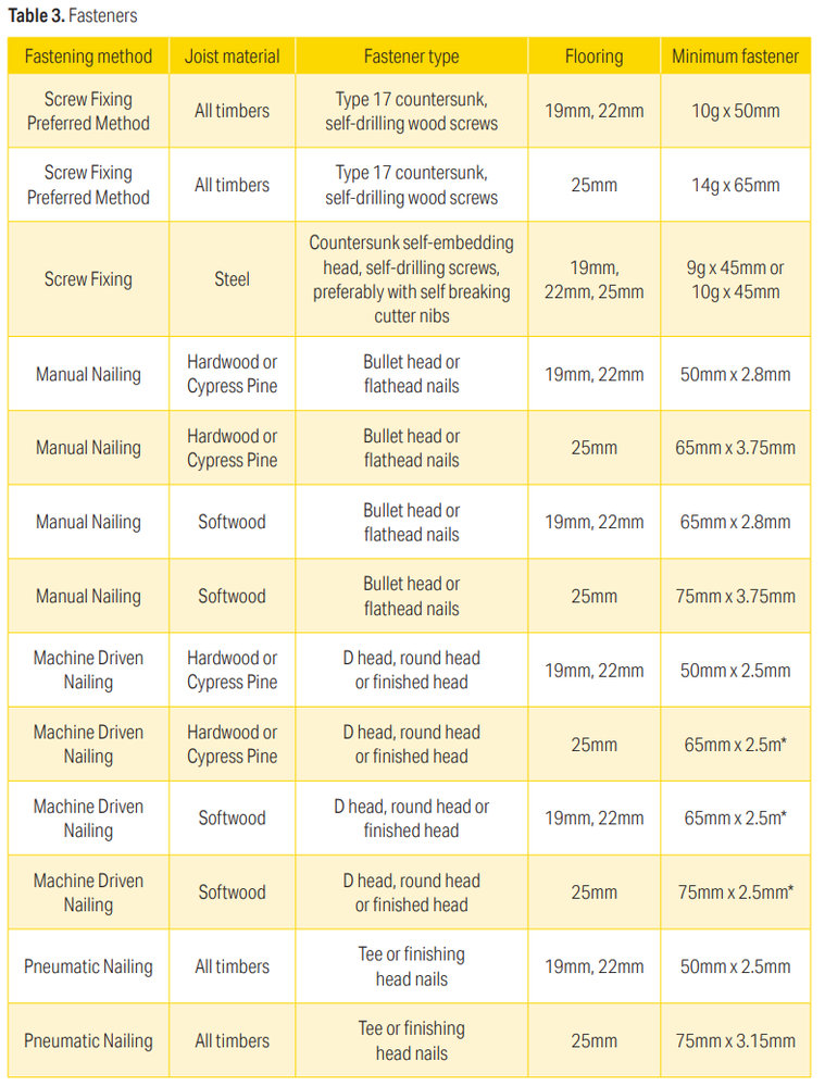

It sounds like you might be considering installing structural particle board flooring, which is tongue-in-groove. I've added the fixings chart below for your reference. It's preferred to screw the panels down. You can choose to use a nailer or do it by hand, but there are quite a few fixings per panel, so a drill or machine nailer would be best.

If the structural flooring is the same height (19,22,25mm) as the existing boards, then I recommend you change to it. It would be far easier and faster to install @rick6947, and it would also be more suitable for complying with current building regulations.

that was my thoughts just trying to work out what nails to use as I don’t want to use a gun.

Re: How to install solid timber flooring?
Would screwing them down be an option @rick6947?
They require 40 fixtures per full sheet, so driving the nails by hand would be a bit of a mission. We hire framing nail guns for the day, which would be a lot easier.

Thank you for your detailed plan not against a framing nail gun hire would these be suitable for flooring and is there a nail gauge that you would recommend?

Hi @rick6947,
There are different requirements for the various thicknesses of structural flooring and the type of joists you have. Details below.
