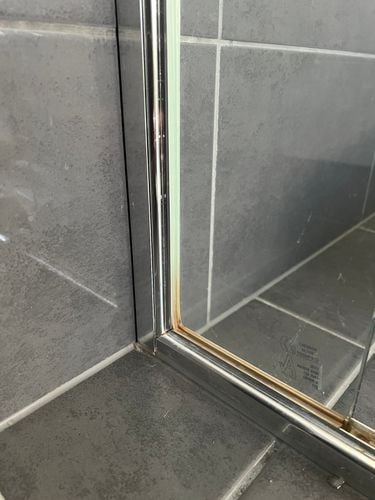

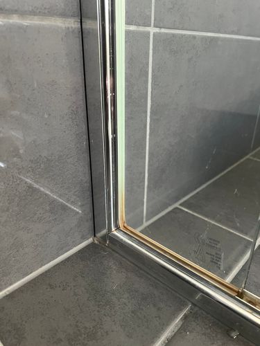

I’ve just moved into this house and the silicon around the bottom of the shower is brown, can this silicon easily be replaced? I’m a complete novice, so I don’t want to wreck the shower. If I can replace it on my own, can I please have product recommendations and instructions?

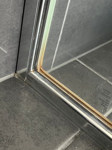

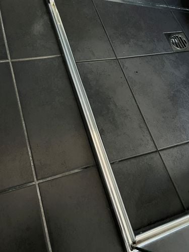

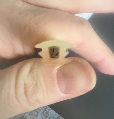

I also removed this solid silicon from the bottom of the frame (see photos to see silicon and where it was removed) but i’m unable to remove the stains and get it clean enough to slide back in… is this something I can purchase from bunnings? Or is there something I can put in there instead? (Sorry for the quality, it was the best photo I could get)

Hi Mitchell,
Thank you for responding
with regards to the silicon, it goes all the way around the shower where the glass meets the frame, do I need to scrape out all of it before cleaning & replacing? Or can I just cut out the brown portion and blend the old and new silicon togther?
I also just wanted to clarify, the solid silicon was not attached to the bottom of the glass door, it was in the slot of the frame, where I would step over to get in & out of the shower. From my research it looks like it’s maybe called an infill? Would I still need to contact the manufacturer or can I put something else in there to fill the gap?
Thanks!
Hi @sarahjaynex,
It sounds like you might be mentioning the silicone gasket for the shower glass panel where it meets the frame, rather than a caulked silicone. If this is the case, the glass panel need to be removed and the gasket replaced, which isn't really a DIY job. If it's the one in your second and third images, then this is a silicone gasket and can't be cut out and filled. This gasket not only seals the frame, preventing water from escaping, but it also holds the glass panel in position and stops it from moving.
The only shower seals we carry are for the doors to cover the gap and prevent water from leaving the enclosure, not silicone infill pieces or gaskets for the glass panels in the frame.
That, unfortunately, doesn't leave you with many options. Are their any brands on the shower screen that would help you determine the manufacturer?

have you found anything out on the removable silicone strip? I’ve been googling for literally years trying to find out what it’s called & where I can get a replacement. For what it’s worth our house was built by New Generation (Summit) in 2014. I’ve searched all our building paperwork & can’t find anything about our shower screens

As Mitchell mentioned, it is a specialty product that is usually supplied by the maker of the frame or a glazier who is installing it. They are often referred to as glazing wedge.
You might be able to find a suitable replacement by looking for this search term.
