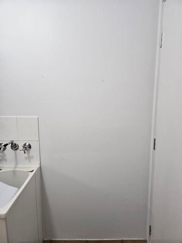

I'm currently trying to install a collapsible bench for my laundry, as space is at a premium but there is unused space behind the external door, which we rarely use.
I've settled on a 18mm thick merbau panel for the benchtop which I've cut to 850x600 and varnished to make it waterproof. My plan is to secure to the wall using Carinya 300x145mm folding spring loaded brackets which should take the weight easily and allow the bench to hide behind the door when not in use.
My question is about where to fix the brackets on the table and wall as the stud placement makes it a bit tricky. From left to right from where I want to position the bench, there are studs available at 50mm and 460mm of the 850mm width of the bench. Is it better to fix the brackets to the studs but have them spaced unevenly across the bench, or place them evenly on the bench (e.g. at 200mm and 600mm) but have them not on studs (in which case I was thinking I would use GripIt 50kg Plasterboard anchors - they'll show up under the brackets but only if anyone looks closely)? I've attached a picture for reference. The bench is intended to sit pretty much flush against the side of the sink with about 70mm of clearance being left on the right for the door. The stud positions are marked.
What would the best practice be in this situation?

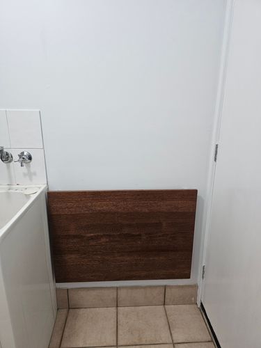

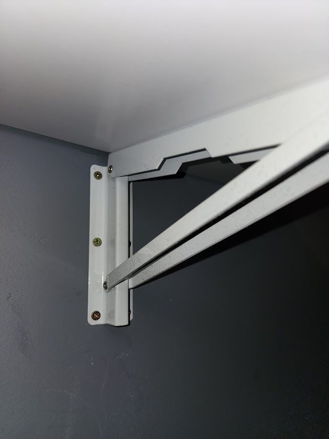

Thanks again @MitchellMc and @Noyade, I finally got around to putting it all together and I'm very happy with the outcome. Easy to use and fits really well behind the door and under the door handle.
Re: How to install a collapsible benchtop?
Nice work @WilliamDeBanjo!
Those Carinya 300 x 145mm White Folding Spring Loaded Brackets have done a fantastic job turning a previously unusable space into a usable working space.
