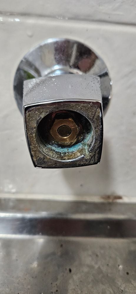

I'm wanting to update the taps in my 70's inspired house, the original ones are just too hard to turn on and off but I don't understand how they are removed, under the top cap is a bolt and nut. Even if I take the nut off, the bolt just turns with the tap and then comes to a stop when it's fully open, how do you unscrew these?

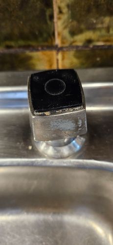

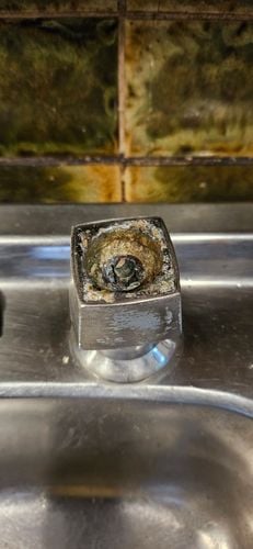

In the kitchen it gets a bit stranger still, no nuts on the bolts, just a 8 pointed star washer sitting over the bolt.

Strange 8 pointed star washer sitting over boltHi,

The nut in the middle can be removed by using a socket set or long nose pliers. Once the nut is out, you'll be able to pull the handle up and out. However, if the handle is stuck, I suggest spraying it with WD40 in the middle and rocking the handle left and right to loosen up the calcium deposits that have anchored itself between the spindle and the handle.
You'll feel the handle slowly coming loose and that should be enough to allow you to pull the handle upwards. On the off chance that the handle will not budge, please post a photo of the centre of the handle with the nut removed. This will allow our members to assess its assembly. We can then make recommendations on how to remove it.
Please make sure to wear gloves while attempting to pull the handle up.

I will give it a try soon, the threaded bolt seems VERY attached to the handle on all of my taps, I will post a pic if I cannot get the tap off.
