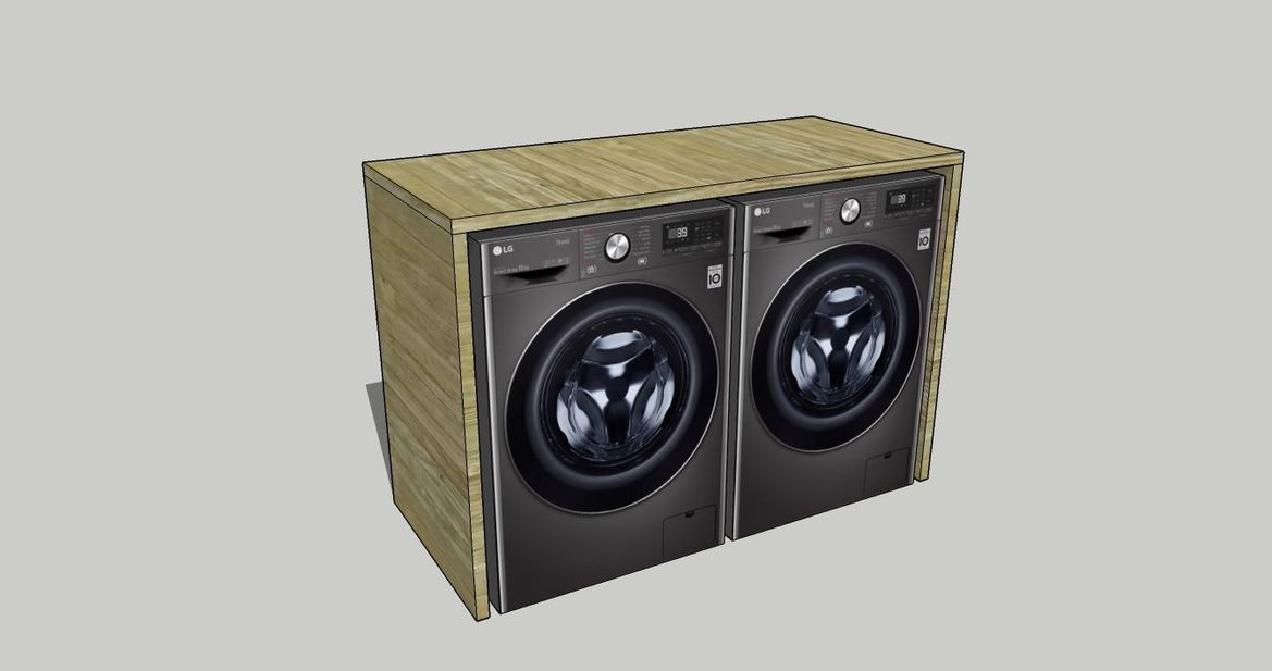

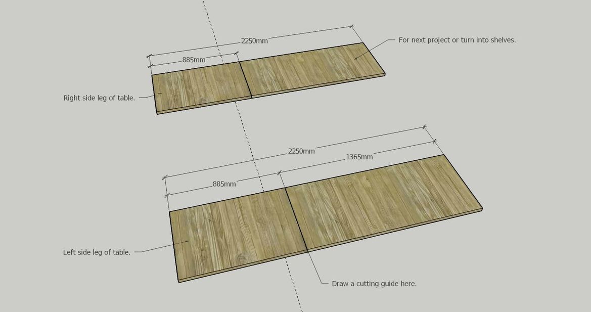

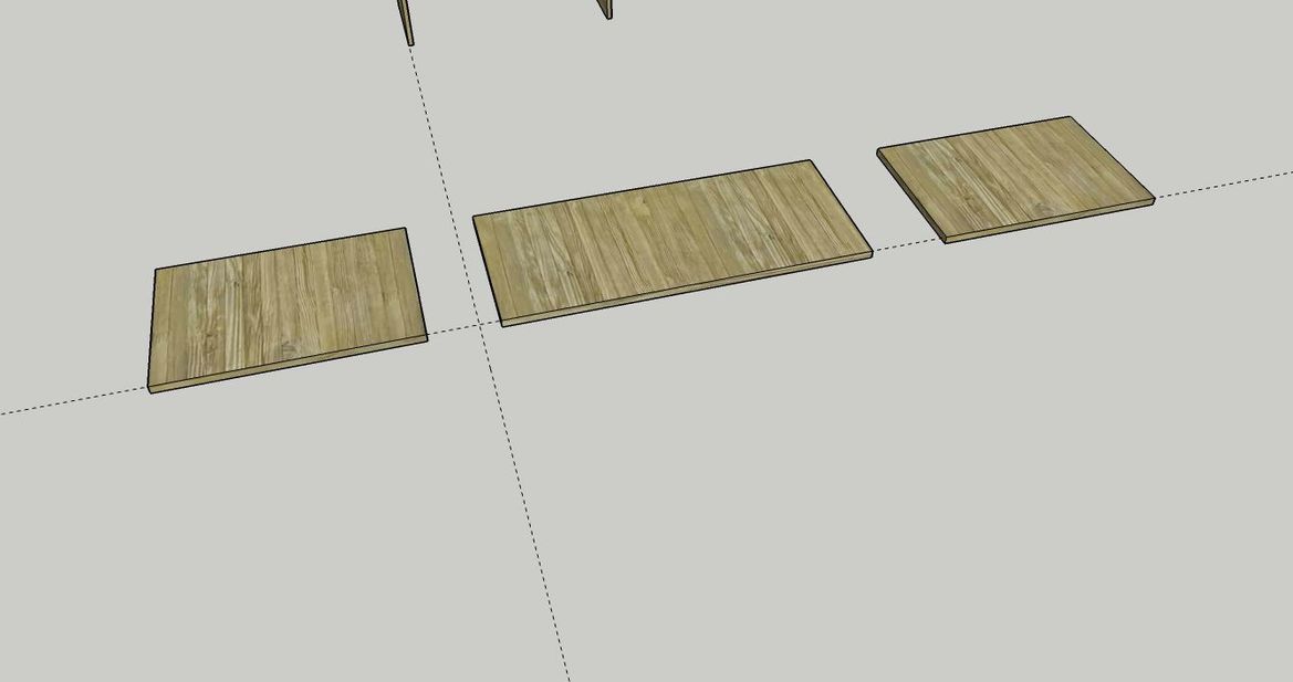

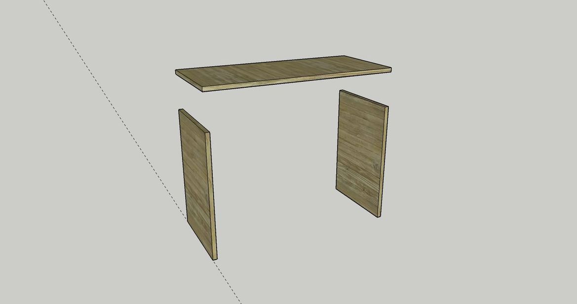

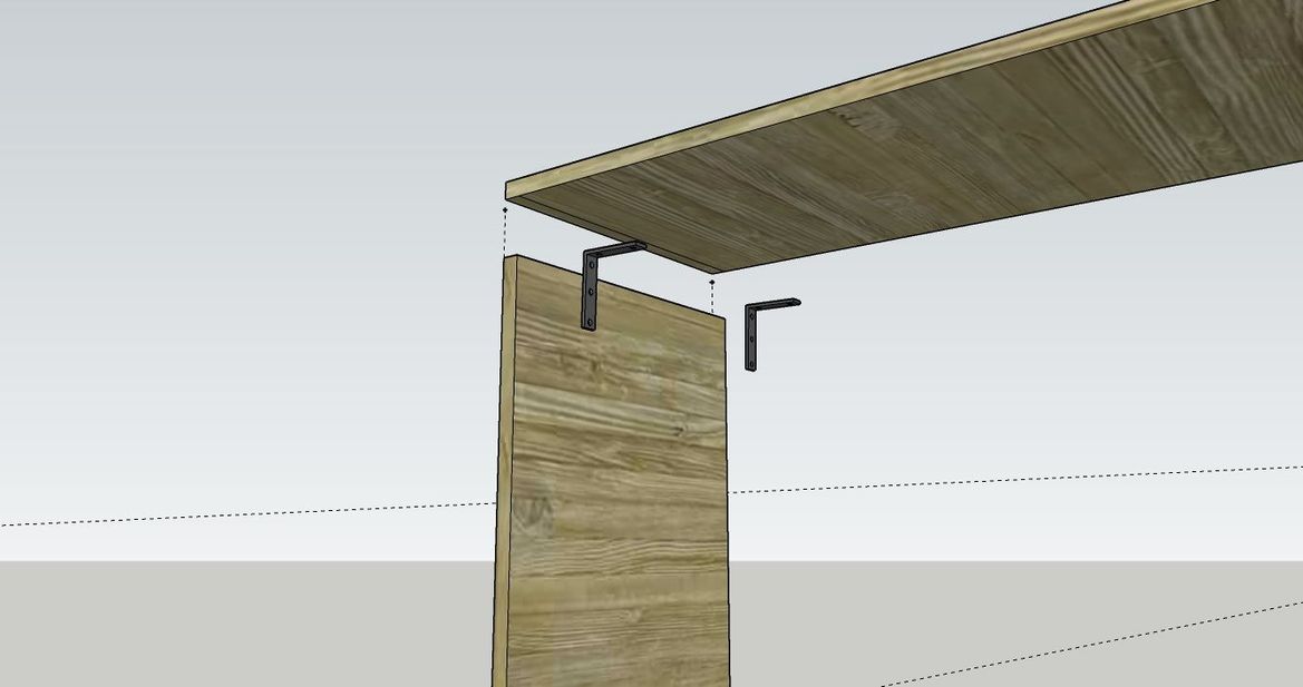

Walking around the store I happen to come across 2250 x 600mm 30mm Plywood Pine BC and realized that this would make a perfect laundry table. In order to build it you would need two of the plywood panels, four Carinya 100 x 125 x 25 x 6mm Black Heavy Duty Manhattan Angle Bracket - single - Black, one packet of Zenith 8G x 28mm Gold Passivated Countersunk Rib Head Chipboard Screws - 38 Pack and one pack of  Zenith 8 - 10 x 60mm Treated Pine Countersunk Head Screws - 50 Pack.
The general steps are to cut the plywood to the width of your washer and dryer plus 30mm overhang on each side to join the legs on. It's important to provide a gap of 25mm on each side and in the middle of your machines to provide vibration space for them. The leg panel must be at least as tall as your machine plus 25mm for the vibration gap. Connect the leg panels using the 60mm screws and make sure to use a minimum of four per leg. Attach the angle brackets at the bottom and use the 28mm screws to secure them.
Sand down the panels and I suggest painting it with Feast Watson 1L Satin Liming White Stain And Varnish for a nice finish.
Have a good look at the illustrations and if you have any questions about the assembly please let me know.
