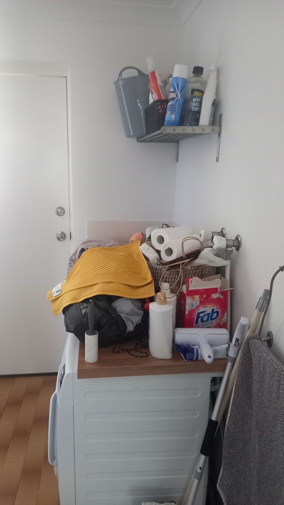

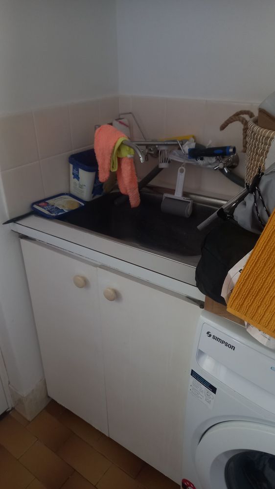

I need a little help please. I am about to start a DIY renovation of this bathroom/laundry on a budget. Right now I am struggling with the lack of laundry storage and the small gap between the washing machine and the shower.
I am thinking to save money I will paint the walls and tiles and install a new vanity of the same size. I thought installing a narrower laundry sink and then having a benchtop over the washing machine would be good but I can't find any cabinet on Kaboodle or anywhere else that is designed for a washing machine?
I'm happy to pay for a plumber/electrivian to change the position of the taps/outlet to streamline the laundry section and make every look neater. I'm happy to replace the tiles above the laundry sink as well.
Happy to hear any advice or ideas on how I can transform this space! I'm also wondering what is the best order to do all of this?
Thanks!

Before you start tiling, it’s a good idea to check with your local council to make sure you’re following the proper regulations for laundry waterproofing in your area.
Since you’re retiling the wall, you’ll want a cement-based patching compound that provides a strong, stable surface for tile adhesion. Bunnings stocks the Dunlop Ardit Rapidset Repair Mortar, which is designed for filling gouges and uneven surfaces in concrete and masonry. It bonds well to the existing surface and provides a solid base for tile adhesive. If the damaged areas are deeper than 10mm, apply it in layers, allowing each layer to set before adding the next.
Before applying the patch, clean the surface thoroughly and dampen it slightly to improve adhesion. Use a steel trowel or wide scraper to spread the mix evenly over the gouges, ensuring a level surface for the new tiles. In regards to the gap near the window, I suggest covering it with a piece of timber so that there will be something for grout to land on when the tile gaps are being filled.
My best advice is to make sure to give the mortar patch enough time to cure before you begin tiling.
