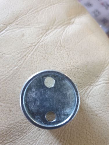

Hi after these brackets to attached towel rack to wall. If anyone has any ideas. The one pictured is too big, or perhaps someone might have another way to do it. Thanks

Hi ive misplaced the brackets
and so far can't c where I can get them. Need 2 b just under 2cm across. Help pls
Do you happen to know the brand, or was this one of our heated towel rails? It would be best to contact the manufacturer to see if spare parts are available. It is essential to use the correct bracket because it is an electrical device. If you were to use the incorrect bracket that doesn't use a suitable grade of plastic for the heating element of your unit, this could lead to a house fire. I've seen brackets melt on units they were designed for, so you should be very careful with using anything other than what's supplied by the manufacturer.
