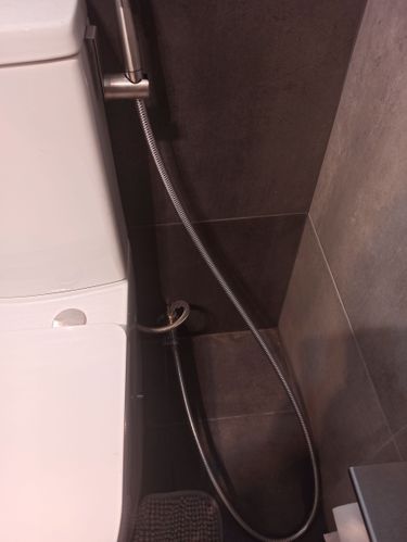

Hi There,
I have the bidet spray installed along with the back flow preventer but the hose pipe becomes stiff once the water is all filled up in the water tank.
You can see the stiffness of the hose pipe in the attached image

I believe what's happening is that too much water pressure is building inside your bidet hose causing it to stiffen. I suggest calling your plumber back and asking them to install a pressure reducing valve so that water pressure does not build up in the hose or you turn the water off after each use.
Unfortunately, there are no other items you can attach to your bidet hose that will relieve the pressure. Worst case scenario is that so much pressure will build up in the hose it will start to produce a leak.

I'm sorry but the part I suggested can only be installed by a registered plumber. They will also be able to determine the type of valve needed. They will need to examine the bidet and then make a decision as to what type to install.
@humaid - I suggest getting this fixed sooner or use the turn off feature permanently. I know of someone who had a pipe puncture (remember these are rubber pipes wrapped with some metal for appearance) and it was a nightmare post that replacing entire flooring.
