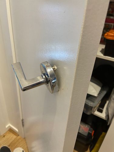

Hi @algenebautista,
This appears to be a dummy knob screwed directly into the face skin of the door. Ideal a handle should be fixed into a solid timber piece, but on an internal door that far from the edge, it is just a thin MDF skin and a cardboard waffle internal packer. The skin of the door does not provide enough purchase for the screw to withstand the rigours of opening the door, especially if the door becomes stuck or there is a catch system to hold the door closed.
If this handle has worked for some time before being polled off you could remove the cover plate to access the screws and shift the handle over slightly to find new material for the screws. This issue will likely occur again in the future. I'd suggest that if you are going to move the handle slightly, before you reinstall the screws squirt some construction adhesive behind the handle mounting plate. That way, when you tighten the screws, it will pull the mounting plate onto the door and sandwich the glue. You'll then have a mechanical fixing and glued bonding. Neither is a great option on their own, but they might give you the needed connection to prevent the handle from coming off again.
Alternatively, you could swap the screws in the handle out for screws/bolts that are long enough to pass the whole way through the door and have a nut on the inside.
