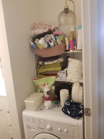

I don’t have enough storage in the bathroom, and it looks quite untidy, so I would like to improve it by putting an upper cabinet above the washer machine, but I don’t have any experience, so I would appreciate your advice as it will be my first ever project.
Below is a photo of the current space for reference, as well as a picture of the cabinet style I have in mind. Thank you in advance for your assistance!
Current space

For a more straightforward approach, you should consider what premade cabinetry would fit in your space. You'd simply need to assemble it and then screw it into the studs in the wall. I can assist with selecting items for you. Could you please provide the space between the walls and the height from the top of the washing machine to the ceiling? Presuming you have the height, you could stack two 600mm wide wall cabinets on top of each other.

Hi MitchellMc,
I think I should follow your advice and install a premade cabinetry. The measurements are 1.53 H x 69W x 60D.
Thanks,
Katherine
Hi Katherine (@katty305),
Many thanks for those measurements. You'll just squeeze in two wall cabinets with a little space to spare. Here's a rendering of what it might look like.
