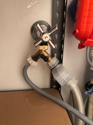

Is there an alternative to the Nylex brass two way manifold? https://www.bunnings.com.au/nylex-brass-two-way-manifold_p0176445
If I were to install this, the height of the manifold + the height of the dishwasher fitting is too large for the space that I have.
I have 185mm to play with overall.
I am currently manually changing the cold water connection as and when needed. Not ideal!
Something like this would be ideal, but I am not sure if this product is appropriate given all have a hard thread (not plastic) https://www.bunnings.com.au/holman-2-way-y-tap-outlet_p3120268
Thanks in advance for any suggestions you can give.

I suggest adding these two pieces to your laundry tap. First is the Brasshards 20mm Brass Female / Female Threaded Elbow. Please make sure to use a Kinetic 12mm x 10m White Standard Thread Seal on the tap before screwing in the elbow. Second is the Brasshards 25 x 100mm Galvanised Pipe. Again, please make sure to put thread seal on both ends to prevent leaks.
From this point, you can now install the Nylex Brass Two-Way Manifold without having to worry about space. Please note, I suggest putting at least four rounds of tape around the tap. The elbow does not need to be screwed all the way in, but it must be facing in the right direction when you install the two-way manifold. You'll see what I mean once you have the elbow and extension piece attached.
If the space is still inadequate, I suggest getting a Kinetic 1.2m Washing Machine/Dishwasher Double Ended Inlet Hose in combination with a Brasshards 20mm Brass Threaded Hexagon Nipple. Connect the hose to the tap and place the brass nipple at the other end which will allow you to connect the two-way manifold.

Hello @JMK007 (Justin)
You can also try the Pope 2-Way Brass Threaded Tap and the Holman 2-Way Metal Tap Outlet. There are other options in the garden hose and accessories department. But these two are the ones I would recommend next to the Nylex manifold. In regards to the Holman series, you'll need to unscrew the snap lock adapter at the end of the outlet, the thread size is standard and will fit 20mm BSP fittings.
In essence, you're looking for a garden tap splitter, but I suggest looking for the strongest one you can find and preferably made of brass.
Thanks Eric! I was able to purchase the Pope 2-way brass threaded tap this evening, and have successfully installed it.
This option also solved the issue of limited, vertical space.
