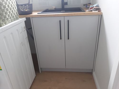

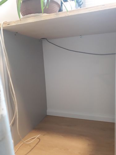

What is the best approach to raise the laundry bench with sink so that I can fit a standard front loader washing machine under it.
There are tiles lining the wall above the bench, should I attempt to cut them by 1 inch with an angle grinder ? How do I un-attach the bench top from the wall with the last damage ? I'm thinking of maybe adding a piece of wood trim under the bench above the sink cupboard to increase the height.

What would be the minimum height raised to allow the washing machine to fit underneath? That's not the washing machine in the photo, is it? If so, that's so very close. Have you adjusted the levelling feet to the minimum height? Can you remove the feet altogether?
In order to remove the bench with the least amount of damage, you first need to remove the sink. Check around the benchtop for any brackets attached to the wall or cabinetry, and remove them. Then, if the bench is siliconed to the tile, break that seal and remove the bench. You might not need to cut your tiles as you could raise the bench in front of them and then reattach it.

I like the idea of seeing if the feet can be dropped or removed if necessary (crossing fingers for you on that)
The bench will probably not be directly glued to the wall, maybe brackets and silicon as MitchellMc suggests.
