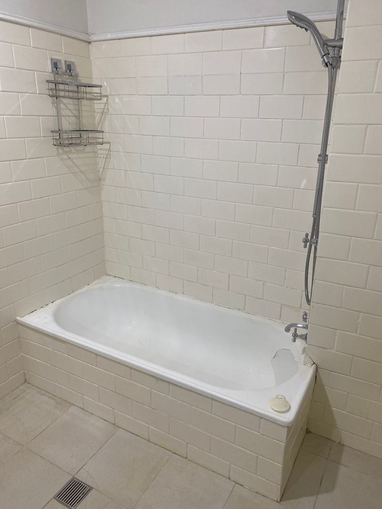

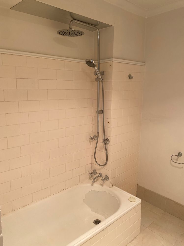

Hi. I've just moved into a house that needs the bath e=re enameling & also needs a shower screen fitted. I live in Newcastle so looking for recommendations to get this project done.

I'm sorry but Bunnings currently does not have a re-enamel coating product for baths. However, we do have a paint alternative. One is called the Rust-Oleum Tub And Tile Refinishing Kit and the other is White Knight 500ml White Tub And Basin Paint.
Both these painting systems are applicable only to metal enamel coated baths. It is not compatible with acrylic baths. The general steps are to sand the surface of the bath thoroughly. The surface is wiped clean and then it can be prepared for painting.
Here is a link to our best advice: Can you paint a bath?
I also suggest having a look at this featured project: Budget bathroom makeover with painted bath and tiles by @raceytrace. It has an excellent example of a painted bath and tiles.
