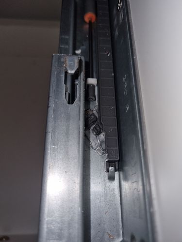

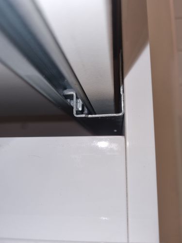

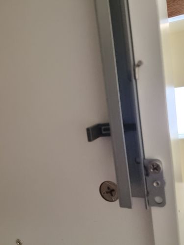

Thanks for the reply Eric. Unfortunately they have used a different mechanism in this product. I'm familiar with the one you have pictured, and I'll attach a couple of pictures myself. Yesterday I visited the store and a helpful team member tried extensively to help. But he was not able to work it out as well! It's a head scratcher.

The screws look in good shape, so are you able to unscrew the entire thing?

In your last image, there is a little black plastic tab and there also appears to be what could be a governor inside the track. If you press the tab towards the track does it retract the the part inside the runner and allow the drawer to slide out?

I did try to unscrew the front screw, and there is a small metal post next to it which necessitated lifting, but it did not move much so I erred on caution. I didn't want to venture in unscrewing at the back, because I wouldn't have that access when installed. Thinking, I'd need access to maintain the pipes/drain/taps.
I'm thinking I'd need to keep top removable then, not gluing down the top may be required.
Yes the plastic tab looks promising, but neither I or the team member at Nunnawading store thought it actioned that! I'll get a closer look.
In regards to the damper, I can manually trigger it, and it retracts to the back, it then re-engages when the drawer is closed. Still no ability to remove drawer, nor does it expose anything more underneath.

Can you please pull the top drawer out fully. Then, look under it just behind the drawer front. Check the two rails on each side. I have a feeling there are two screws that attach the rails to the bottom of the drawer. I believe if you remove these two screws it will let you remove the drawer from the rails.
Take a picture if you can under the front of the drawer when you pull it out and I'll try to identify the screws. Edit: Or, is that them in the last image above? The smaller screw on the right on the little tab. If this drawer is similar to other Modella drawer units, that screw should release the drawer.
Yes, that did the trick.
The Screws underneath the rail at the front need removal and the the drawer will lift up, off the 2 small posts on the rails. Pulling the drawer forward will release the angled metal embedded in the back of the wood. These were quite tight at first as they have cut into the wood. Bingo!
Reversing is now easy, holding the drawer at a shallow angle, lower at the back to locate the metal stops, use you fingers under the edges to hold the rails forward, lower the wood edges down on to the metal posts (which are screw height adjustable), use your fingers to locate the 2 plastic clips on the inside of the rails, they are not used but stop the drawer being lowered flat. The plastic clips don't have a hole to be pushed into it seems. Replace the 2 screws and it's done.
