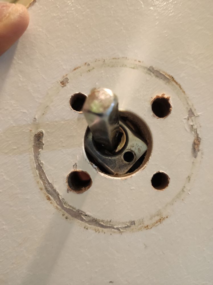

Hi on the other day my Gainsborough 100 series G4 passage leverset stopped working and had to cut open the latch after someone got locked in.
I have removed leverset and trying to remove latch however unable to remove square drive spindle. (Apologies if the terminologies used are not correct - guess work after going through product installation guide).
Tried pullingit, twisting it and even gently tapping with hammer!)
Any suggestions please!!!!
Hi @Neo19. I apologise for the delay in my reply to your question, as I have been waiting for clarification.
The manufacturer advises removing the black rubber 'O' ring which in on the spindle. Presumably, that will allow the spindle to slide through the latch mechanism.
Please let us know if that fixes the issue for you. If it doesn't I'm happy to look into the issue further.
Hi @MitchellMc thanks a lot for your prompt response. It worked like a charm.
Can't believe I didn't even notice the black ring before! ![]()

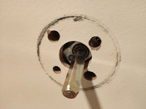

Hi Guys...
I am trying to replace the current Gainborough Privacy G4 handle so that I can use it in another room. I notice the block "O" ring but have not been able to get it out.!! What is the best and easiest way to remove that "O" ring so that I can get the spindle out.!!!

@Jolly181 hi sorry about the delay. What @MitchellMc suggested should work.
From memory, I have used a precision screw driver with pin tip because I had it with me.
Any narrow strong implement would have worked in my case as once you insert it between the O ring and the spindle, you could easily remove the ring as it was very much pliable. Sorry if my explanation isn't clear enough.
Once I got the tool the whole task took barely seconds, it's that easy!
