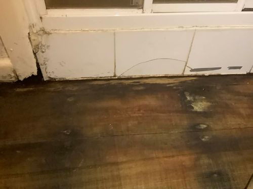

gap beetween shower door likely issue of water at bottom coroner ...i suspect
no wet or damp but not sure since when wood color is like that
shower base
added few photos

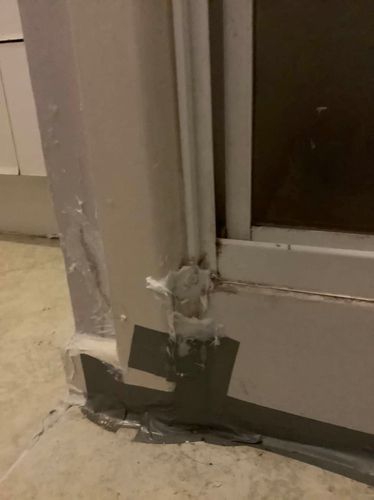

will try removing vinyl floor but worry if unable to put it back to avoid further damage. i couldn't find rotted wood(just damp might be due to gap between vinyl where wood is exposed) under vinyl but found only near shower coroner (just below where shower door gets closed).there is gap when door is closed (attached photo)and most likely water spilled out from it during taking shower.

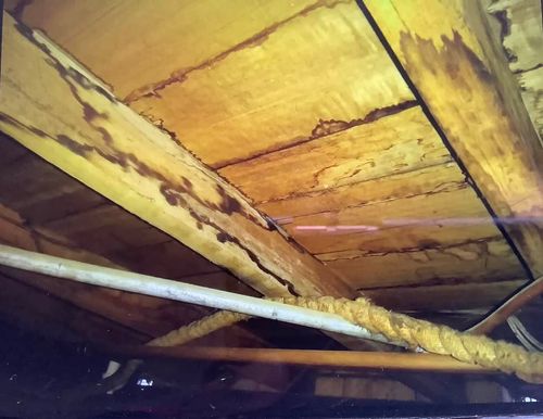

might try to get to know how much damaged wood is and cleanup/remove temporary tape/silicone etc to find exact damage during weekend. As in photos didn't found any damp when checked below shower(house on stumps)

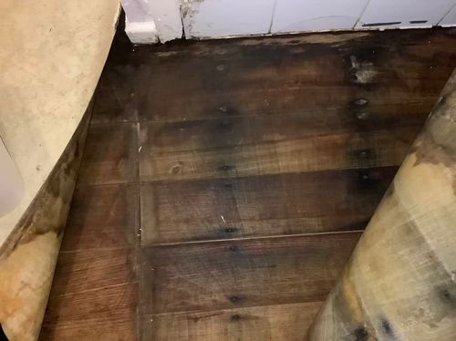

Hi @vik20,
The first thing I notice from your additional images is the dark water staining marks under your floor. All those dark marks are from water seeping through the floorboards. Due to the amount of staining, I suspect there is a leak, and it's not just from occasional splashes of water escaping over the threshold of the shower.
I believe you are on the right track by conducting a further investigation. If there is a leak within the shower tray, you'll need to have this fixed.
Keep us updated, and let me know if you find any cracks once the silicone has been removed.

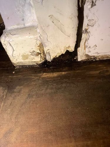

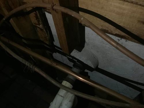

Hi @MitchellMc thanks for reply.
yes you are correct. It might be due to some leak at coroner of shower pan. Attached few more pics. The coroner has rotten wood. after removing rotten wood I can see hole from below the house if i remove one wood which is there for support. Will try and check from where and how much water leaks.
now i wonder how to fix it?. Being a newbie to renovation, is there any DIY solution to fix it without need to redo whole shower? The coroner is pretty bad and it is where water might be leaking. Rest of wood near shower area is damp but not rotten. Don't know how to fix it....rotten corner. bit of hole which is on side and below shower pan
Thanks
If water is leaking out from inside the shower through that crack, it means there is a breach of your water-proofing membrane. This isn't a simple D.I.Y. fix and would likely mean removing the shower base to repair the membrane. Can you see any cracks in the Pebblecrete floor? Pay special attention to the corners where the wall meets the floor. There are not really any temporary fixes that I could suggest that would solve this issue. You could try painting the whole floor and lower portion of the walls within the shower recess with a few coats of Betta TileCare 1L Tile & Grout Sealer. If it is only a very fine crack, then the product might fill it up. This won't solve the issue that the water-proofing membrane is compromised, though.
