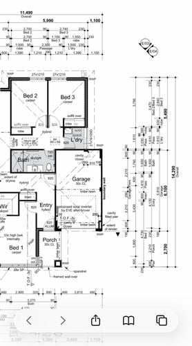

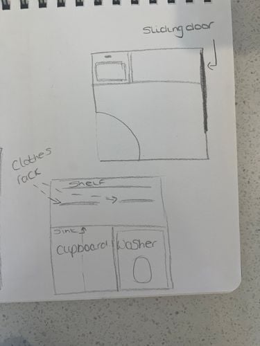

I only have plans of my house build and my idea of what I want! There will be the standard new build sink and tiles over it which I will remove, but I’d like some ideas on how I would install cupboards, new sink, and a counter?! And what to use. Looking to do this as cheaply as possible!

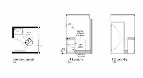

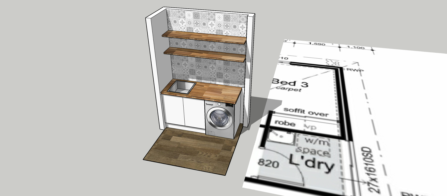

I suggest having a quick look at this guide - How to plan a laundry renovation by @Adam_W. With the available space that you have you can install a 900-base cabinet and a 900/800 wall cabinet of your choice or shelves along with wired clothes rack if you wish.
I suggest looking at the PRACTA cabinetry and the Flatpax cabinetry system. These would be the starter sets for affordable laundry cabinets, but if you are after something with better quality, I suggest looking at the Kaboodle range. In regards to benchtops, I suggest looking at the Specrite 2200 x 600 x 26mm Timber Multi Use Pine Panel. It can be stained and sealed and is easy to cut and install.
