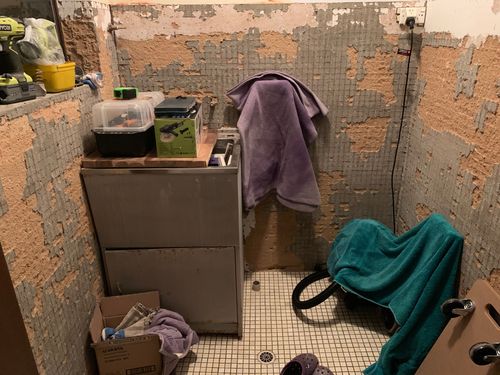

I’ve finished taking mosaics off the walls. I bought a cheap wood chisel set, and used them to knock the tiles off the wall.5C216E0F-8669-463B-8F98-23BB97F4F6D0.jpeg It’s clear (now) that the bottom half of the wall hasn’t been hard plastered.
I thought I would use some Davco render to get myself a smooth surface for re-tiling. Chose Davco, because I’m going to use one of their tile glues.
Does anyone have thoughts on whether this is a good/bad idea?
It’s not obvious from this photo, but rust is a major problem in my place, and I’m going to have to cut the trough fixings off with an angle grinder, as they’re rusted in.

Could I also check, by the picture I'm not sure if you're tiling onto cement Sherrie plasterboard, or it is actually bricks or blockwork.
Or is it actually tile glue you are referring to when you say render.

Hi @gippslandhome - yes, it’s not the greatest photo lol. What you can see is the remains of cement based tile adhesive and the render. My place is double brick, and my previous experience has been tiling on VillaBoard/Gyprock. I’m thinking to knock the rest of the adhesive off, and then use a Davco render to smooth things out, that is, use it as a filler - so would be max of 4mm in some places - sort of a skim coat. However, I’ve read elsewhere of people using tiling adhesive to do the same job - I guess the advantage would be better sticking power? Or, am I’m going to have to use something like Bondcrete with the render? I’m concerned about that substrate sucking the moisture out of the tiling adhesive, cheers Deb :smile:

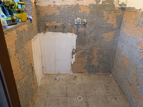

So, I’ve finally got the Laundry to this state

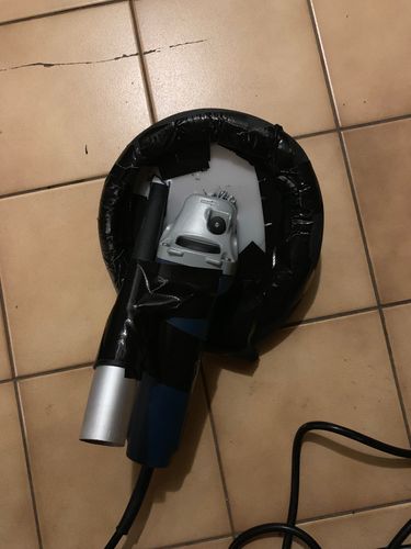

The next step is to grind the floor down, because I took off 5mm thick mosaics, and I’m adding 9.8mm porcelain tiles. Also, this floor has a wicked fall to that floor drain, so bad, I can’t even level my washing machine. So, I’ve purchased a Dual Row Cup Grinding Wheel for my angle grinder. Next problem is the amount of dust this is going to create, so I built a DIY dust extractor (which I haven’t tried yet) from a hack I found on YouTube.
This is the view from above,  on the left hand side is the  nozzle from my Workshop Vac ......C8E65AA4-1514-44C0-88EE-CFC8FFA5C638.jpeg
This is the view from underneath with the grinding disk attached.
Basically this is built out of a plastic Uni Pro paint bucket lid, a piece of plumbing pipe rubber insulation and a lot of Gaffa tape - found this idea at  https://youtu.be/uVJL-yyhGr8h - I’ll let you know how it goes 😂

Absolutely love it @Mathy . I love the look of that idea. Awesome job. Definitely let us know how you go with that one.
And little Macka from Mackas Planter Boxes Post says don't forget the PPE. wink wink
