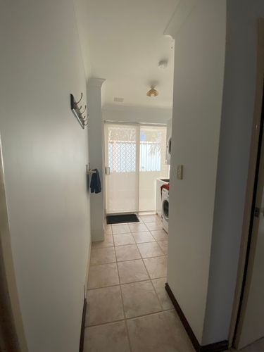

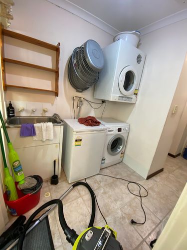

Laundry , Toilet and Hallway needed a refresh.

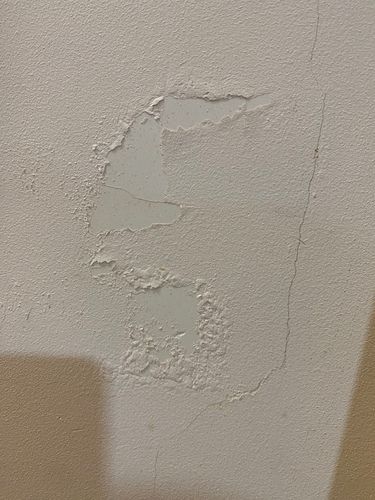

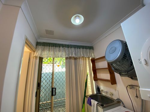

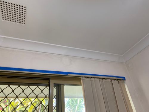

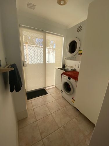

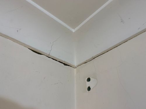

This is before photo , clutter, vertical blinds falling off and using wire to attach them again, ceiling water stains and walls stained and scuffed badly. Pretty much movement cracks throughout. I had water damage on the walls from the shower, seeping through the grout. I fixed that problem with the advice from the team.
Nearly 30 years old. Time to sort it out.

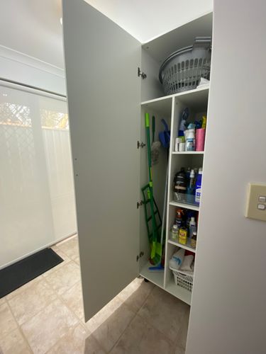

And this is after. Clutter GONE. Moved the dryer over to make space for a Broom Cupboard. Ceiling and walls painted. And good bye vertical blinds 😆 it is so much easier to keep tidy and clean. Heaps more natural light. Feels like more space now if that makes sense. I’ll walk you through the steps.

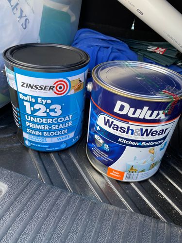

Zinsser 1 2 3 Undercoat.
Dulux kitchen and bathroom Ceiling White .
Dulux kitchen and bathroom wash and wear - Colour - Lexicon Half.

I removed the wall shelves, too much clutter. My young bloke helped me remove the dryer from the wall as it was too heavy and bulky for me to remove. I removed the curtain valance I think you call it, 30 years of dust buildup behind it never again.

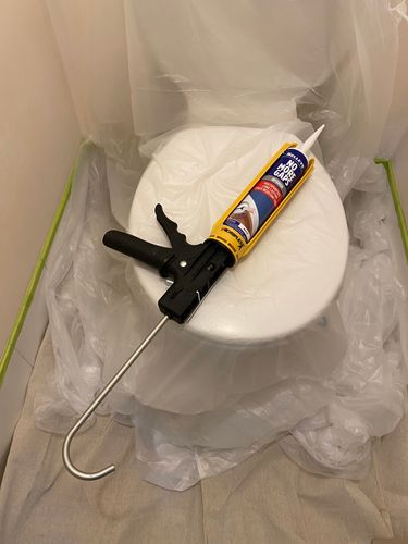

Then filled all the holes with the Selleys Spakfilla. I then filled the movement cracks between ceiling and walls. I used my multi purpose scraper tool to remove a lot of loose plaster from the cracks and filled in with Selleys No More Gaps. Wiped them down again with the duster and then wiped with a damp cloth again.

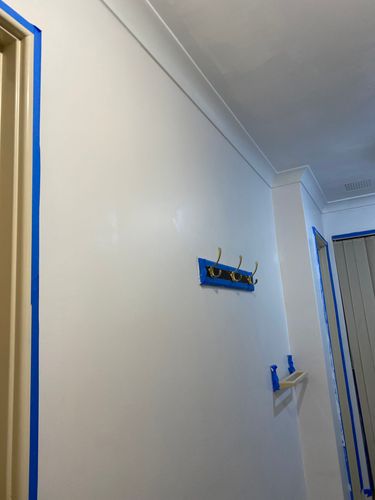

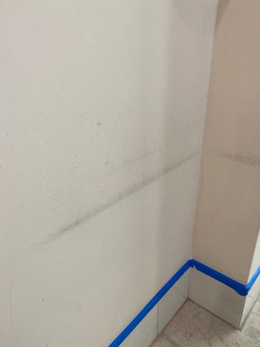

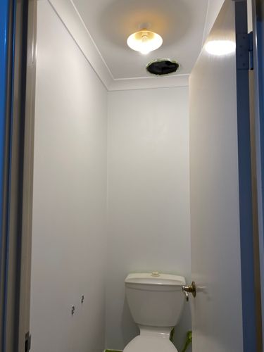

Now all the cracks and holes were dealt with i had to wash the ceiling with sugar soap as it was dusty and dirty. I used a mop. The ceiling had water stains and the walls were so badly stained and scuffed marks everywhere. Filled in all the gouges on the walls. I put painters tape throughout to protect the tiles, trim , skirting boards ect.
I used Zinsser Bullseye 123 as the under coat for both the ceilings and walls. It works great for the heavy stains BUT also works well with the old paint peeling from the shower grout seepage. I scraped the peeling old paint, sanded it down, wiped dust with damp cloth. Then added the undercoat.

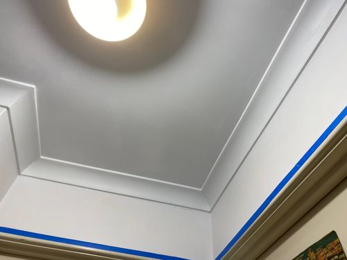

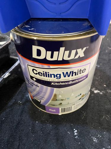

I painted the Ceilings first with Dulux Kitchen and Bathroom Ceiling Paint for the added protection against mould ect. I used it in both bathrooms, toilet and laundry.
All the walls in the laundry, toilet, hallway and even the two bathrooms are painted with Dulux Wash and Wear Kitchen and Bathroom, low sheen. Colour is Lexicon Half. I absolutely love the colour as it changes colour during the day and night.
Ok painting done, hubby helped me move the dryer above the washing machine and drill new holes in the wall to hang it up.

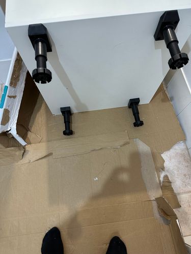

Now the broom cupboard…..

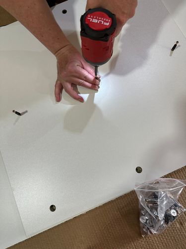

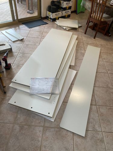

We purchased a 600mm one door broom cupboard from Bunnings

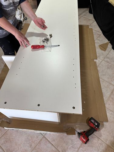

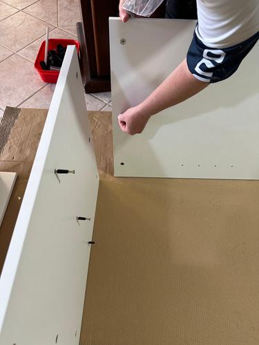

I had my hubby help me with this as you do need a second person to help holding the pieces together while you are assembling it.
The instructions were good to follow.
We had a YouTube video of how to assemble it which was fantastic. A team member named Donna from a Bunnings store. Very helpful. Love the Bunnings YouTube videos !!!!!!!!!!
We assembled the cupboard inside and used the boxes they came in to work on so we didn’t damage any of the pieces.
With the broom cupboard being so tall, just take care moving it around and also we attached a safety chain on the top of the cupboard and bolted it to the wall.
We are happy with the refresh, well overdue. You have no idea how happy I am to see the vertical blinds GONE.
