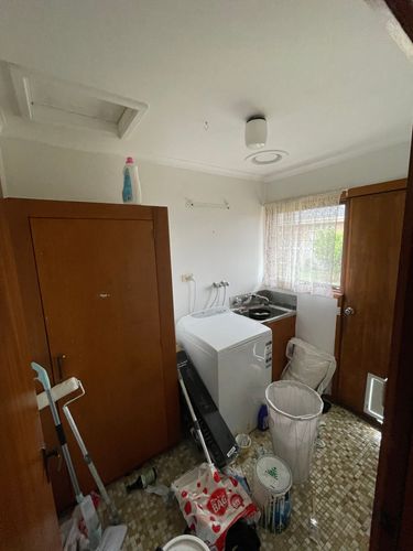

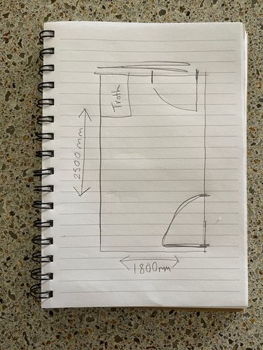

Hi guys, moved into my house 12 months ago and after repainting and reflooring the entire house it’s time to update this old stinker of a laundry.
its 1800 wide and 2500 long.
any recommendations would be perfect, I’ve been lurking around previous posts but I can’t seem to find similar to my measurements.

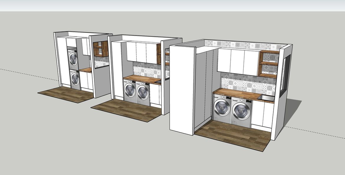

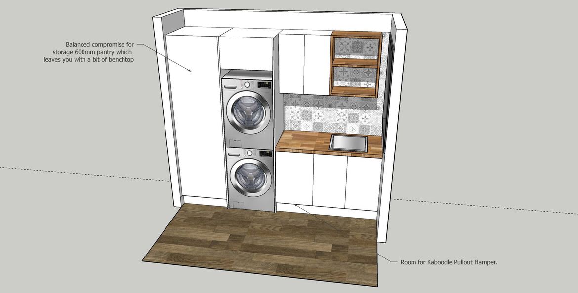

I've put together a design for you below. Let me know what you think, and we can change some things around if you'd like.

Thanks for the reply Mitchell,
looks great, I might have a play on that myself.
I will be changing washing machine to a front loader so I’ve got more bench space and yes I’d still like the full length cupboard for brooms ect.
What you’ve done looks great.
I'm glad you like the design @Tarkswalsh! Front-loaders will be so much better bench space-wise. I've included the price list below.

It's great that you've received excellent advice from my colleague @MitchellMc. Just to add to the suggestions made. I think it's important to consider how you'll be moving about in the laundry. Aside from looking great, I think there has to be a folding area and a spot to put the basket on when you've taken the wash out of the machine.
Will you be using it as a linen storage area or is it a dedicated laundry room? If space is at a premium inside the house, I suggest maximizing the storage area in your laundry. I've seen some fantastic designs where they have long benchtops, but that's because they have room to spare. It's a tricky balance between style and functionality.

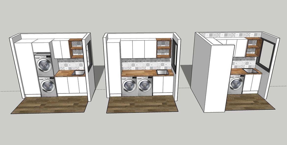

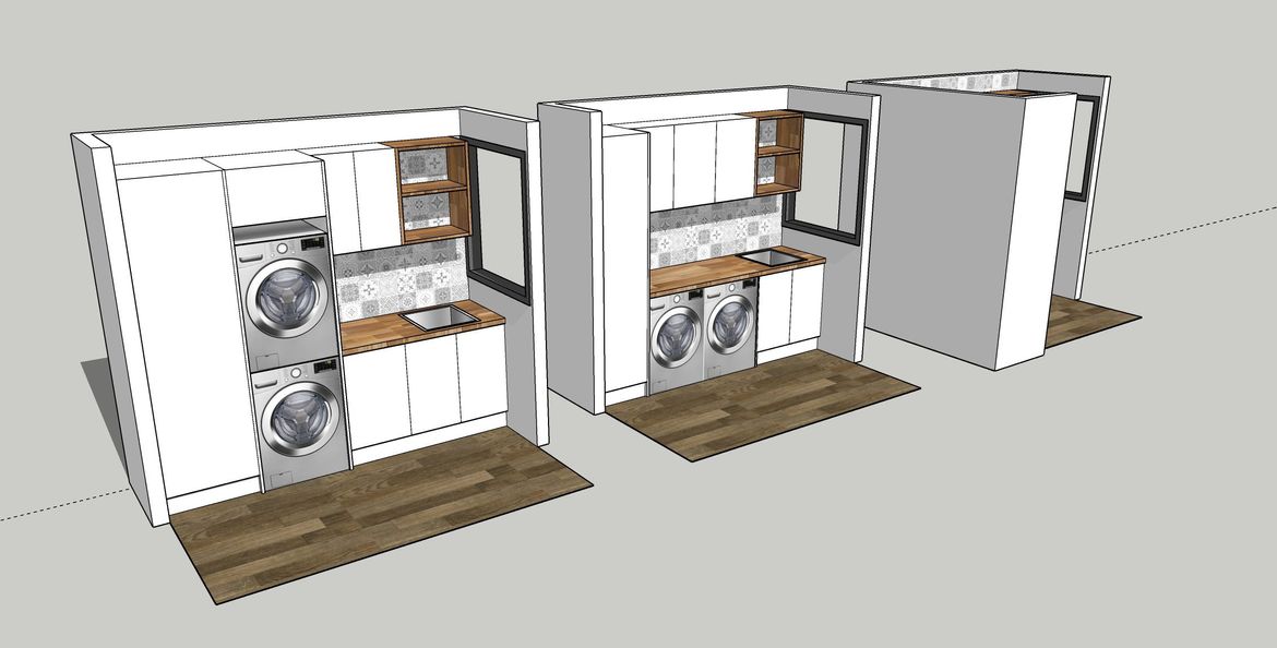

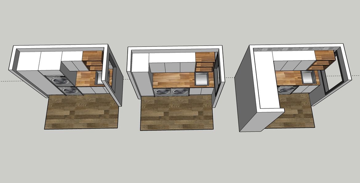

Great ideas by @EricL and @MitchellMc.
There are lots of things to think about, most of which are not thought about for a 'simple' laundry 🤣
As Eric said, storage is a biggie for a laundry because it can help take care of a lot of clutter from the rest of the house. Your big initial decisions are: front loader or top loader washing machine? And are you having a dryer too?

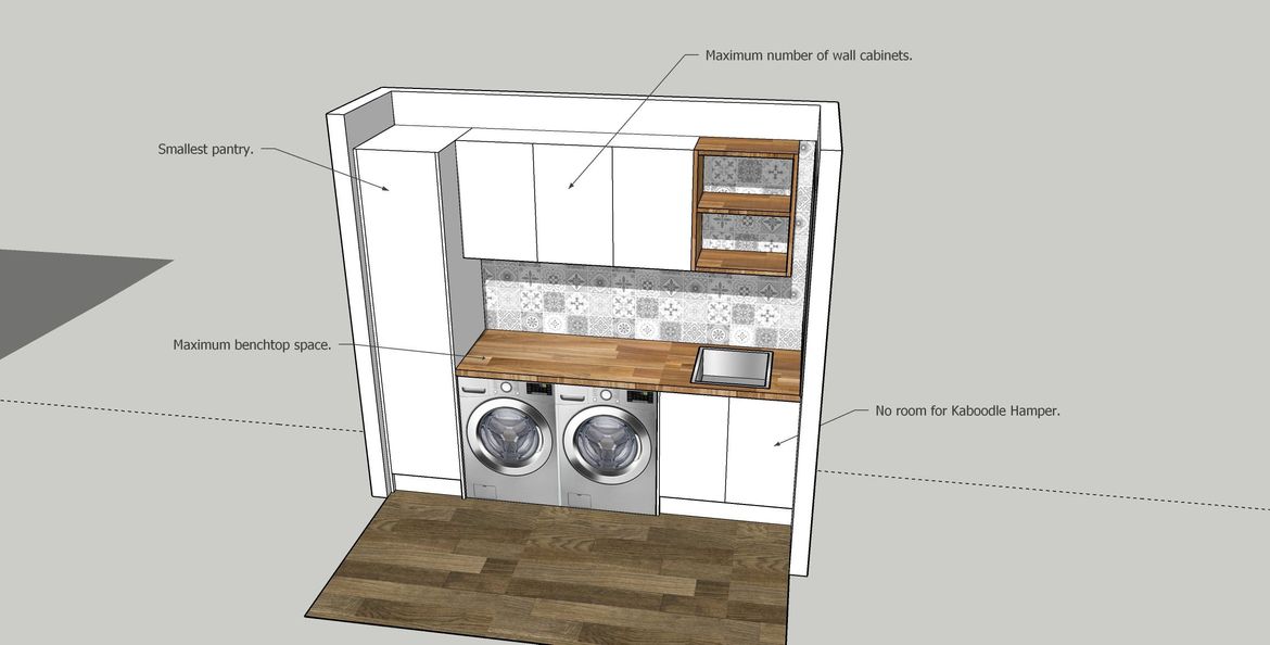

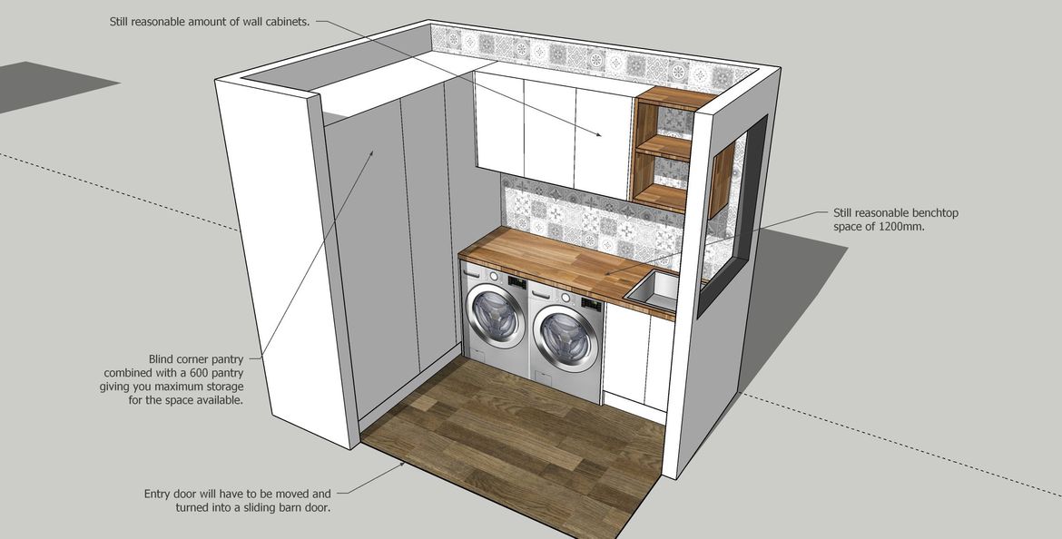

The next thing to watch out for is access to your roof hatch. For this reason, I would not recommend Eric's first suggestion because the wall cabinets protrude too far for a ladder to lean against. It's also a convenient reason to keep the cost of your renovation down by using shallow wall shelving instead of cabinetry (Bunning have lots of options for this). And it may also be a reason to ensure the washer and dryer are on the floor side by side. P.S. Always try to put your washer closer to the laundry tub and drain than the dryer.
Two next issues to consider are the window and the space beside the entrance door. It gives a much nicer feel to the room to have the window unobscured, so @MitchellMc idea of placing the wall cabinetry further away is great. Only go closer to the window if you use shallow open shelving.
Your budget might dictate whether you go for option 2 or 3 from @EricL plans because the tall pantry's are significant. I like the third option best because you get way more storage BUT from your drawing, you might not have the depth behind the internal door to put the pantry in. In which case @EricL option 2 and @MitchellMc designs will both work best. You may have space on the empty walls to install a hook to hang your ironing board or brooms etc, depending if you want the pantry to have lots of shelving or for tall items.
