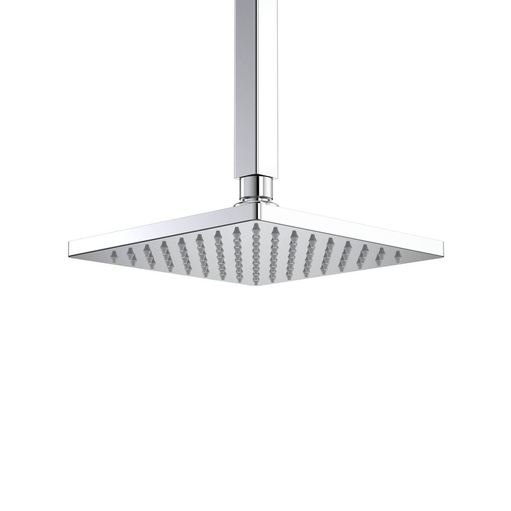

I have a bathroom with rain shower only coming off the ceiling. Seem like a great idea at first, but now not so. Prefer the option of having both rain shower and hand held shower especially with a lil one.
How can i convert the shower for dual usage without hacking the walls to fit the hand held.
Currently the plumbing is from the roof connected to a rain shower as below. Any advise and likely cost is much appreaciated

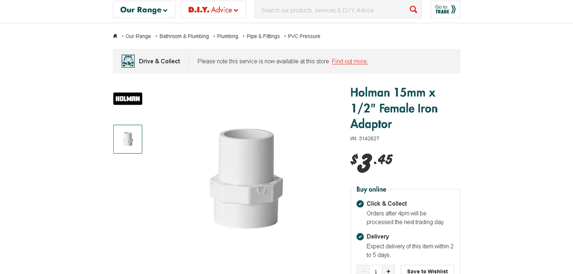

Hello @ManDhanoa

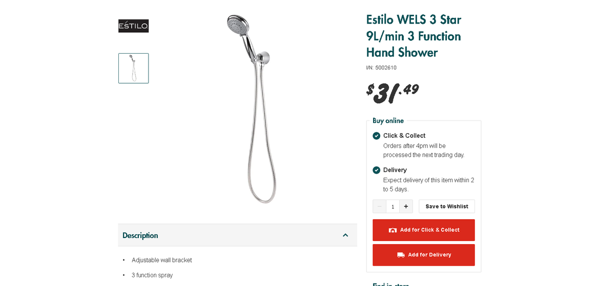

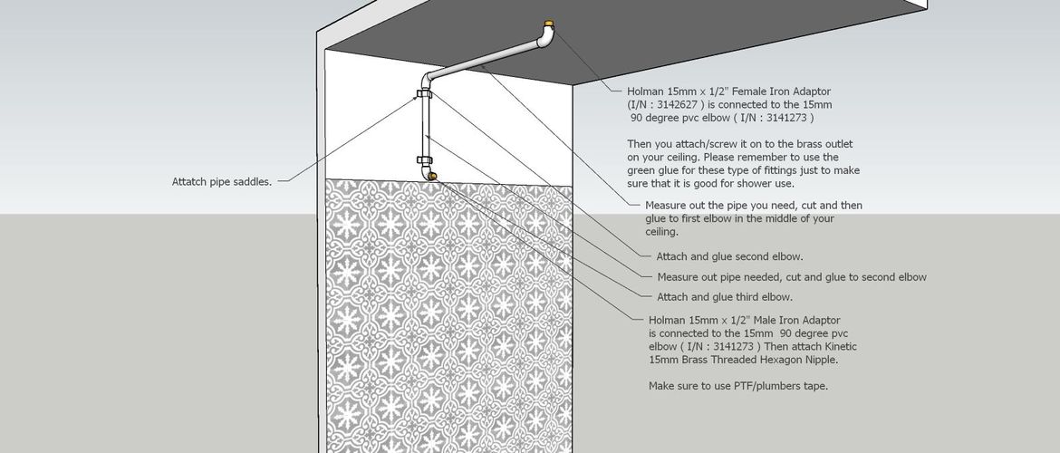

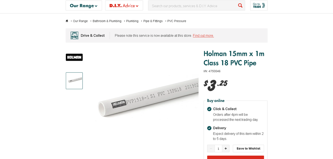

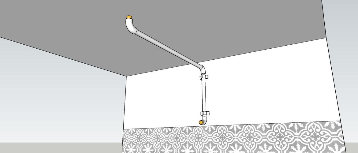

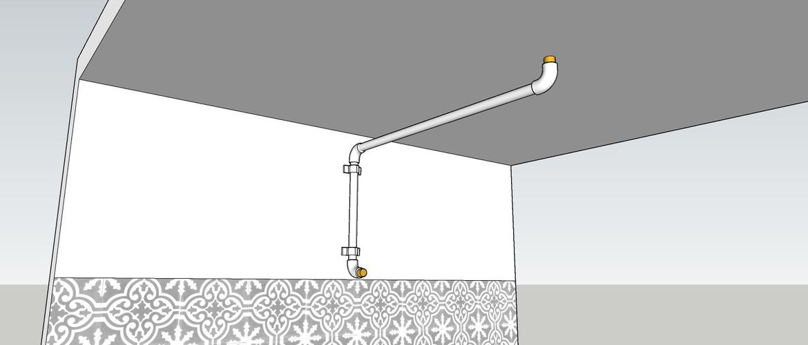

Attached below are my suggestions for this particular issue. It's not the flashiest but it will solve the current dilemma of the rain head diversion. This is more a semi permanent solution without having to tear the whole place apart. Very affordable and easy to do. I hope it works for you. Good luck and stay safe. In the last set of instructions I say you should use a male iron adapter ignore that and just use a female one since you will be putting on a brass nipple.
