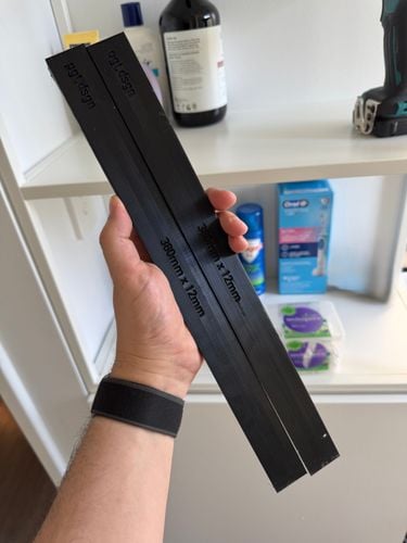

Well you do it with some of these bad boys! About 12 of them to be exact. One of the many, many things I have been getting into while I was away was 3D printing, and well, when you have a hammer, you soon realise everything becomes a nail.
Many of the tutorials i found online for removing mirrors off of drywall / Gyprock call for wood shims, something which whilst I know they probably exist out there (and honestly do the job just nicely), I threw together a design in Fusion 360 (my CAD program of choice) and designed a tapered shim that gently tapers from a 0.5mm tip, up to a 12mm length over as big of a length as my print bed could handle. There's a thicker piece at the end of the shim that gives you a much sharper angle for the latter stages of removal, as well as acting as a nice handy handle for you to get a good grip on them when pushing them in. They're printed from PETG plastic (similar plastic as to what's used in water bottles) with a pretty thick amount of infill.

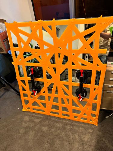

To get the mirror off the wall, we firstly taped the mirror up as much as we could using some high strength heavy duty masking tape. We used a pair of Trojan two-cup suction handles as well to make it easy to handle the mirror when it eventually pops off the wall. The tape will hold the mirror together if in the event that it does shatter. Some small shards of glass may fly off, so i'd also recommend wearing safety glasses, gloves and closed-in shoes to protect yourself from the potential of flying glass shards.
I would also not do this kind of job alone if the mirror is large, Say larger than 800mm squared. I'd absolutely get a mate or your partner to come in and help.
Mirrors are not made from tempered glass so they will crack if bent too much. However, unlike tempered glass, mirror glass is surprisingly flexible as it's made from annealed glass. It'll bend a lot more than you think it should, but don't go overboard.

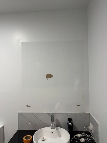

...and voila! This came off super cleanly with only a few small spots of drywall coming with it.
Patching these tears was a cinch. I took some drywall compound, filled in the gaps and then proceeded to pop on a coat of Dulux One Step Prep in order to, let's be honest, fix up the absolute hashjob the builders did when they put this mirror on the wall in the first place.
Some 80 grit sandpaper, that mentioned filler, and a coat of undercoat later, and it's ready to go for topcoat. We're going with Dulux Wash and Wear Semigloss paint in Miss Universe white to match the rest of the bathroom.

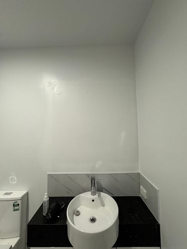

To update you all, I put the mirror cabinet together and installed it last night, and well... The pictures speak for themselves, really
I got this cabinet from a certain Swedish Meatball Purveyor. I was looking at options from Mondella (the Rococo was actually what we first had in mind), but this particular cabinet (an IKEA FAXALVEN) fit the space more closely, being 1000mm wide as opposed to 900mm wide. It also featured a light driver that could be integrated with our existing Zigbee-based smarthome meaning i could use any Zigbee compatible light switch to turn it on or off.
The next thing to do is to print up a conduit to go down the side of the cabinet close to the wall (which will be magnetically closed) to organise the cables that are coming from the top and keep them all nice and tidy.
We're also getting a sparky in to remove that power socket and temporarily terminate it while we replace the cladding on the wall with some Kaboodle plastic splash-back cladding. The vanity itself is 1100mm wide and the gap between the vanity and the cabinet is about 360mm, so a couple of pieces of this cladding should do the job just nicely. I'll be cutting the cutout for a quad socket using the CNC router function of my 3D printer, and getting the electricians back in to fit said quad socket.
