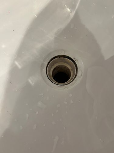

Ideally I’d like to change the bath plug to a pop up basin waste plug but there is no thread in the drain and I don’t have access underneath (tiled bath). Is my only option to change grate? If so how do I do it. Is it just putting silicone down and then putting new grate on?

Welcome to the Bunnings Workshop community @Peacefularya. It's sensational to have you join us and many thanks for your questions about replacing a bath waste.
Can you please show us the grate you have removed, including the section that pushes into the drain pipe? We'll need to assess how it connected to recommend a product that you could replace it with. However, I'm unaware of any pop-up plugs that would work with your current pipework.
Hi Mitchell,
there wasn’t any part that pushed in, I was just hoping there was something out there I could use. It’s just a plain grate. The old one got replaced. I bought a Ezyfix a while back. The old one pulled off so I silconed the Ezyfix down.
since then the Ezyfix has come off (two years). I
removed all the silicon as was partly black. I just wasn’t sure if I could replace it with a pop up plug (probably not as no threads in piping) or whether silicon down the current grate was right. Thinking actually I might need plumber putty.
Hello @Peacefularya
I'm afraid the only bath waste I'm aware of is the Kinetic 40mm Chrome Bath Waste With Plug. The other pop-up waste units are for basins only and are too long to be used for baths. I'm surprised that you managed to remove what was originally there before you used the EZYFIX 50mm Chrome Retrofit Waste Insert And Plug Sink/Bath Repair Kit.
Generally, a bath waste is secured from the bottom with a large nut that fixes the waste in place making it difficult to remove. As you've noticed the only way to access the bottom of the bath is by removing the tiles on the side of the bath which is an expensive exercise.
Since there is no indication of a leak, it's possible for you to install a new EZYFIX plug and waste. If the budget permits, I suggest getting it fixed professionally by a licensed plumber. That will include tile removal and replumbing the bottom of the bath to code.
It is difficult to tell how your current bath is attached to the waste pipe, but should it fail odds are you'll start to develop a leak. It would be better to have it fixed properly than to continue patching up the plug and waste.
Thanks Eric,
hopefully grate will do it. Doesn’t seem to be leaking. Pipe (not sure is this what we call the waste) still in place. Only removed old grate. Was just hoping there was a way to change it without removing tiles but looks unlikely
Oh well new grate (Ezyfix) it will have to be. Hopefully it will stick better this time.
