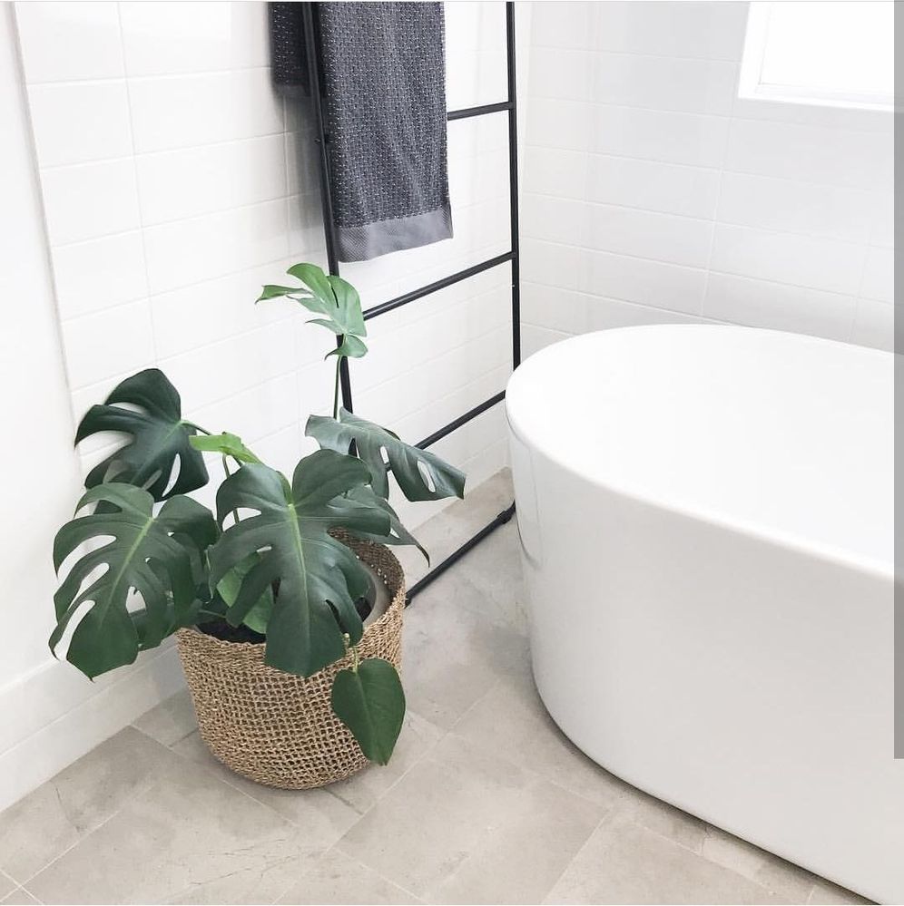

I got this installed in my new place (couldnt find a full size pic on hand)
