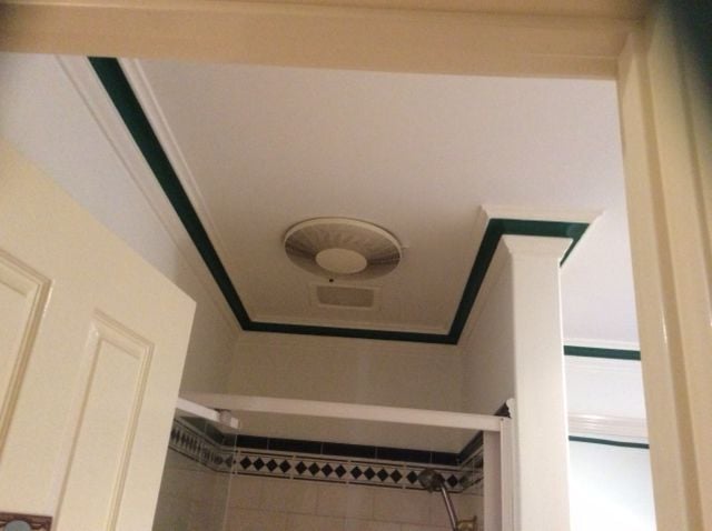

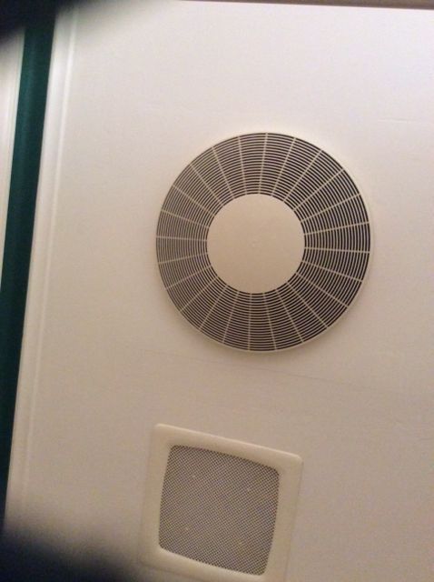

Need to repair plasterboard ceiling in shower recess of bathroom. Damage was caused by rain water coming through roof down exhaust vent. This has been repaired by roof plumbing contractor. I am an electrician. My proposed method of repair, remove exhaust fan and shower light. Cut out a rectangular section of existing ceiling including hemp grouting locking plasterboard onto ceiling joists. Replace with 10mm thick gyprock to same dimensions using gyprock screws into ceiling joists. (pre-cut exhaust fan hole) Allow small gap for applying the fiberglass tape then plaster to seal new gyprock to existing plasterboard. Sand back. Apply another thin layer of plaster, smooth off before applying sealer coat and then finish coat. Replace light and exhaust fan.
Refer photos.
Please advise if the proposed repair method needs changing. Is gyprock a suitable repair medium, is it compatible with plasterboard?

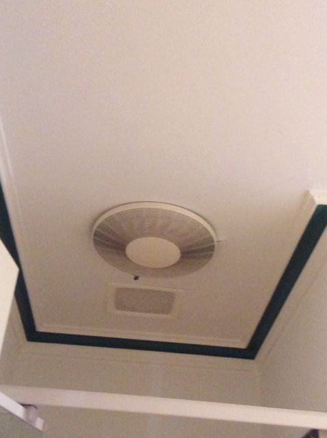

Deb, I bought a Gyprock section from Bunnings, cut it to size 400x540. Cut out damaged section of old ceiling, Cut wooden battens to size and screw them to existing ceiling allowing half of width to extend. Fit new ceiling section then screw onto batten overhang. Sand back original ceiling paint then apply Gyprock Multi Purpose Joint Compound and flush off. Sand back to smooth then finish with Gyprock Final Finish compound. Sand back to smooth then apply 2 coats of ceiling paint.
Refer photo.
Great job @Warren1, well done. Looking forward to seeing your next project. Feel free to post anytime you need a hand or have something to share. I'm sure other members of the Workshop community will be particularly keen to tap into your knowledge and experience as an electrician. Hopefully you will also find plenty of helpful information, advice and inspiration for your projects from our clever and creative members.
