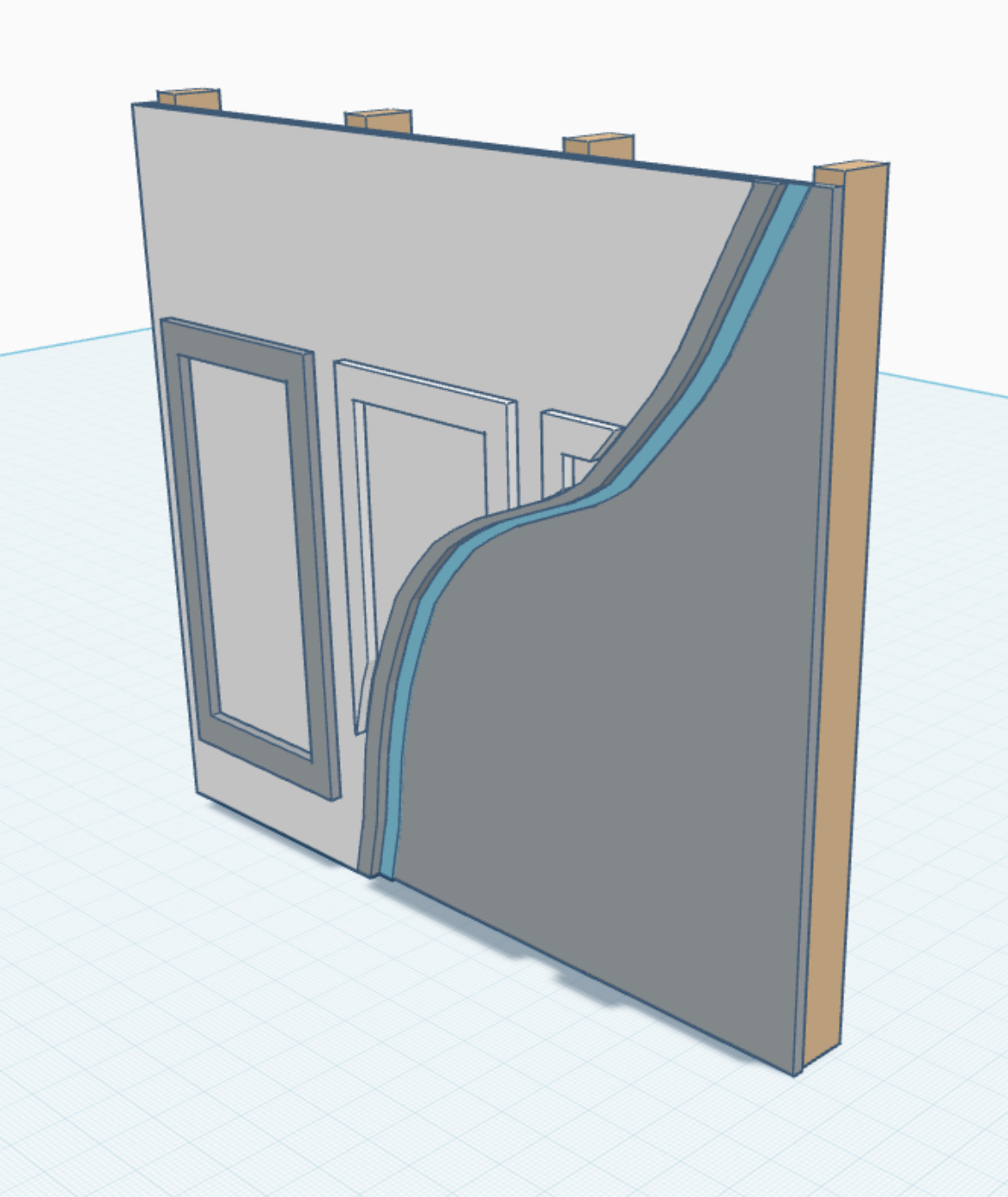

Hi @samh25,
You need a protective layer over your waterproofing to comply with code and protect it from impacts. This is typically tiles. You could potentially clad it with cement sheeting, such as Villaboard. However, you'd need to speak with a waterproofer regarding fixing penetrations through the waterproofing.
So, you'd line that area with Villaboard over your membrane and paint it. Then you'd need to add your moulding on top of it to create the wainscotting. Typical timber or MDF is not going to be particularly suitable for a wet environment. If you are planning on using flat trims you could cut cement sheeting up and use that instead. For something fancier like colonial moulding, it would be difficult to find them in a water-resistant product.
I've created a rendering below to illustrate. Villaboard > membrane > villaboard > trim.
