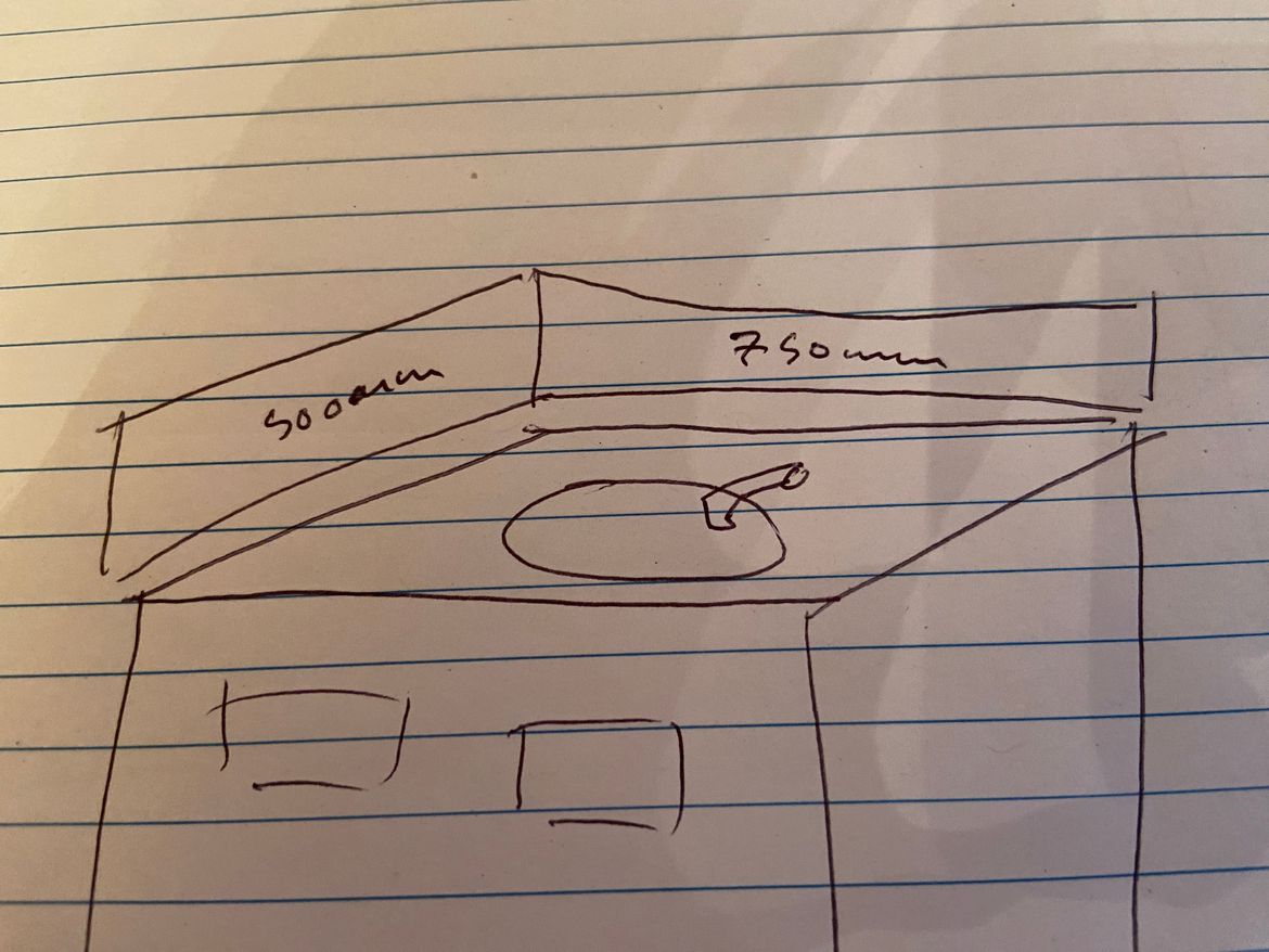

Hi I want a simple acrylic splashback to go around 2 sides of a bathroom vanity/sink top.
7500mm x 500mm
is it possible to get this?
any help greatly appreciated
Welcome to the Bunnings Workshop community @Calderra. It's wonderful to have you join us, and many thanks for your question about acrylic splashbacks.
You could use a Bellessi 145 X 2440 4mm Polymer Kickboard for your splashback. It's 145mm tall and should be around the correct height. You will need to cut it down to suit your 500 and 750mm lengths, which can be done with a circular saw.
